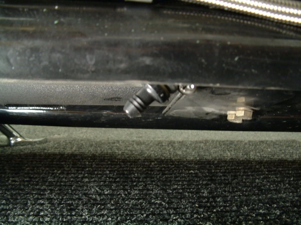

Actually that is probably the rear breather going into the intake backing plate... get some rubbre hose or SS line (depending on bling factor you care about) and run that fucker to the ground as shown in many threads including most recently this one
http://www.bigdogbiker.com/forums/h...-relocating-rear-head-breather.html#post59353
BUT IMPORTANT!!!
Keep the white side of said check valve pointing towards the motor.
Side note...
you can put the check at the top or the floor... doesn't matter
or
as long as the check valve is there and white facing motor!!!

Have to disagree with you on that buddy. Placing the valve closer to the engine will keep the hose from filling with oil like a resorvoir.

I talked to my buddy today (same bike) he has one hose running to the oil tank (return hose requires drilling holes in the oil tank) and then second hose to the bottom of the bike (bearly any oil comes out) this way filter is keept clean. Few hundred bucks fix. :(
