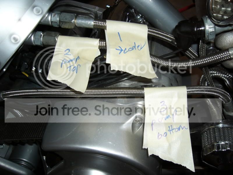

Does anybody have close up pictures where the oil lines route to. Also does anybody know what part # or length the oil lines are for a 06 mastiff? (including fittings) thanks.
Here's part of the picture for a gravity fed oil tank....
On the oil filter housing, there is an inner and outer fitting. The outer fitting is connected to the other cooler fitting. this should account for all your connections at least.
Thanks. I need to see the cooler installed to see where to brake into the system.Also the fittings that are needed. Note: all big dogs are gravity fed correct?
