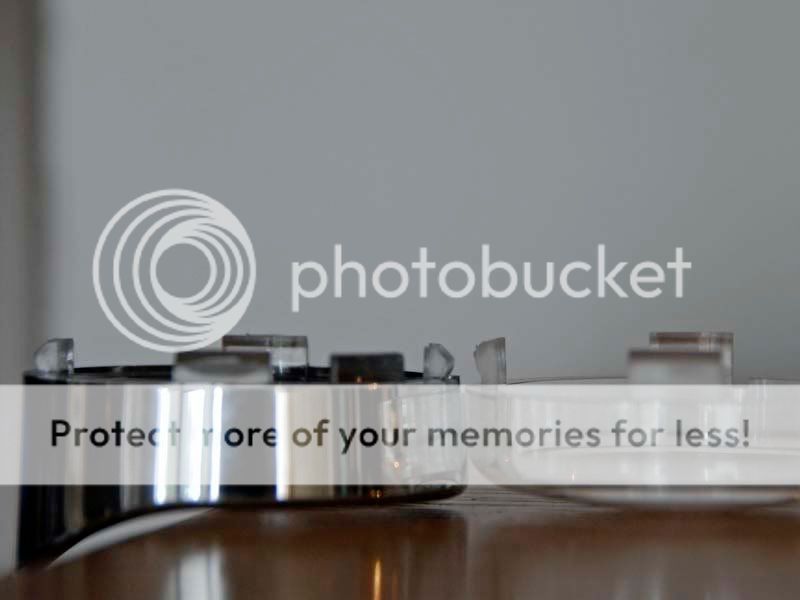

Here is a tip! The lens is where the little locking tabs are located and they can slip forward in the chrome housing if you try pushing on the chrome when installed. Push on the actual lens to seat the locking tabs, you can see how much extra will go in to the signal when you do this and it will have a better chance of surviving the bumps and vibration. I thought one of mine was defective or broken on my softail when one kept dropping off. I was pushing on the chrome only though to re-install as fingerprints wipe off chrome pretty easy. I noticed the lens push out as I pushed in so I pushed the center of the lens with my thumb and I heard it click. Problem solved and they never came off again until I pulled them off.
P8RIOT
Here's a closup pic showing what Sparks is describing. The lens cover on the left is the one from Harley - on the right is the stock Big Dog lens. Notice how the tabs on the Harley part appear to be shorter - they actually are the same length - it is just that the clear lens portion has slipped down inside the chrome outer shell. Be sure to seat the inner lens part completely, and all is well.
Just for completelness, here is a closup of the new cover snapped into place:
Good job P8RIOT, I remember when I got mine and I didn't think they fit until I discussed it with P8RIOT and he pointed out that you have to push the lens on. :flag:

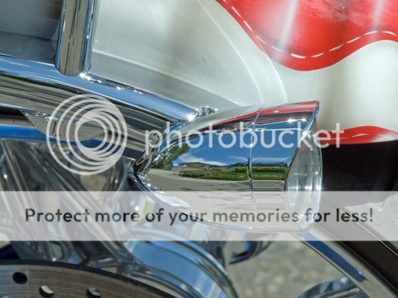

So the standard HD hooded covers just snap in and replace the BDM stock covers? I just ordered 4 new BDM covers from my dealer. The tabs get brittle and break causing them the fall off and/or leak. I like the hooded ones, may cancel the cover order and just buy the hoods.
WB Cycles
These are what I have on my chopper. Also have several other designs in stock, BioHazard, SpiderWeb, Dollar Sign, Three Blade ...
