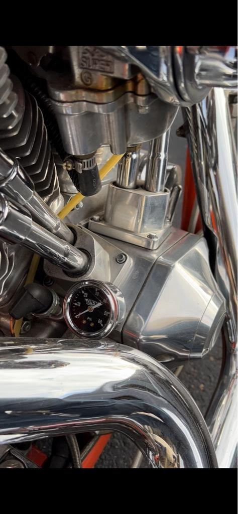

This is the key on bike not running the oil light does light up when the key is on but the bike is not running when I Clean the tapet screen I will take pictures and show everybody what it looks like
So the light is off when its running which it should be?....i watched your videos and i listened to the motor and the top end sounds fine...i believe the gauge is lieing or has a restriction in it or a restriction between it and the tappet screen....possible gauge going bad which is really what i think it is...one possible thing is if the gauge was installed with thread tape , which it should be tape or maybe even thread dope....if installed with the tape a piece of the tape may have came loose and it covering the oil gauge hole or it maybe in the hole...those type of gauges do loose there calibration from trash in them, been hit or dropped etc...new gauge and a tappet screen cleaning and i do believe you will be fine...let us know what you find when taking it out and cleaning the screen

Yeah that gauge is tits up. Get a good Marshall gauge.

I'll get you a couple of pictures tomorrow .
Sorry the pictures are not that good, but I did find out the windows 11 does not have a picture viewer unless you want to subscribe like microsoft Office. Anyway I used Acrobat and looks OK but not that good
CarlosView attachment 108148View attachment 108149View attachment 108150View attachment 108151View attachment 108152View attachment 108153View attachment 108148View attachment 108149View attachment 108150View attachment 108151View attachment 108152View attachment 108153
I like the gauge on the rocker box. Yeah that is a pretty good setup you got there. Appreciate the info! :cheers: :chopper:
