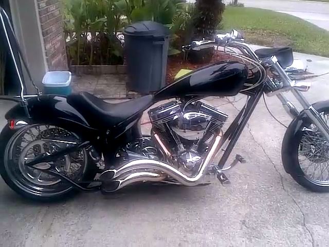

Stainless Creations Chaos II. Snatched these off Ebay and so far so good (really digging the sound)... I'm stripping down the Mutt this winter to give it a more industrial look... "exile" look.... black and brushed/bare aluminum. I plan to wrap these pipes in black wrap this weekend then I'll start tearing her apart for powder coat.. :whoop: First pic is a video of sound...

Chopper Dave had the Chaos Pipes.:2thumbs: I never liked riding with him cause i could not tell if my bike was lit or not:roll:
Just keep an eye on the transmission mount. I have lots of pics on here of my two sets always breaking from my hard use of them. Last set broke at the bracket and then broke of at the rear exhaust flange.
But they did look good and sounded better.
Lastly I wrapped my 2 into 1 to the collector (Wrath?), and when I pulled it off it was about impossible to get off all the corrosion from rain and washing. You may want to consider a heat sealer if you ever plan to remove that stuff.

Looking good man! I love the look and sound of these. Only down fall is the color change after a few hundred miles. The fastest way I have found to clean these is using 0000 steel wool, stainless polish and about 15 minutes of time. Shines them back to new. Enjoy!

I will definitely Seal the wrap.. So this is the beginning of my winter project . Will hopefully have rocker boxes, tranny cover, pulley cover, forks, oil filter mount, triple trees, forks, headlight cover, primary cover, and controls black by the end of winter. I want mostly black with just a touch of aluminum exposed. If the boss allows it I get my phat daddy 50's with black spokes, hubs, rim, with stainless nipples.
