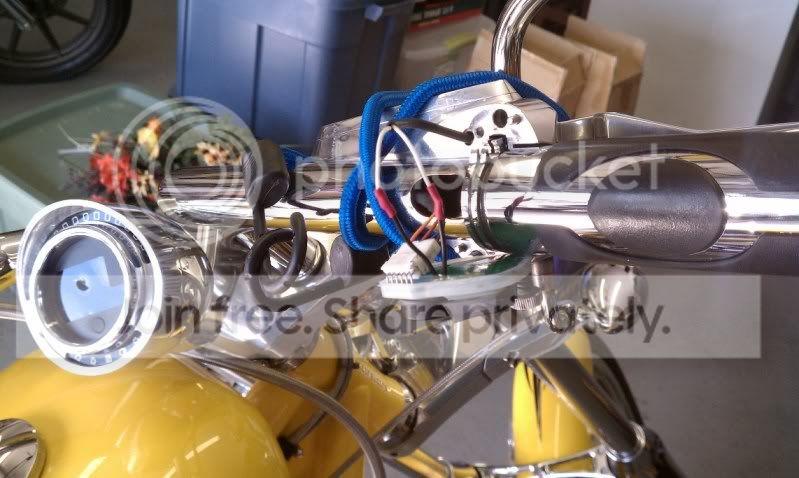

I was getting ready to go for a ride and noticed my hand brake lights were not functioning but the foot brake was. After doing some research on the net and forums for potential problems I decided to get busy. I took the hand controls apart to find this,

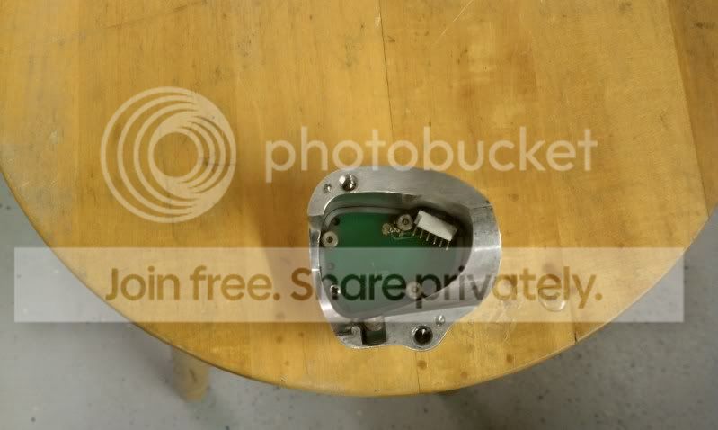

The problem was pretty obvious. Those two white wires are supposed to be attached to the PCB. In the picture they are already stripped back from their shielding so that I could work with them. The wires must have broken off the PCB sometime while riding the bike because they did work when I first got it. Not a very comforting thought to know that your brake light was not coming on. Here is a picture of the board. Just to the left of the white connector is where the wires are supposed to be attached.

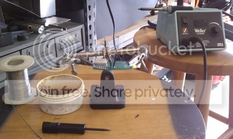

I took some of my own wire and re-soldered it through the board just like it came from the factory, probably better. Also during some further investigation I noticed some dry solder joints for the connector. I went ahead and hit those up with some heat and solder as well. That could have been a potential problem down the road for sure. This is what the board looked like after the new wire,

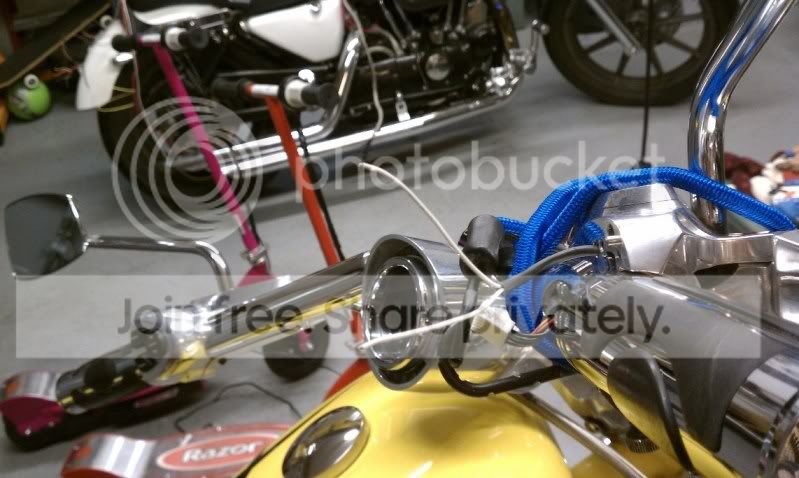

I next took some heat shrink and soldered the wires back to the switch on the hand lever.
