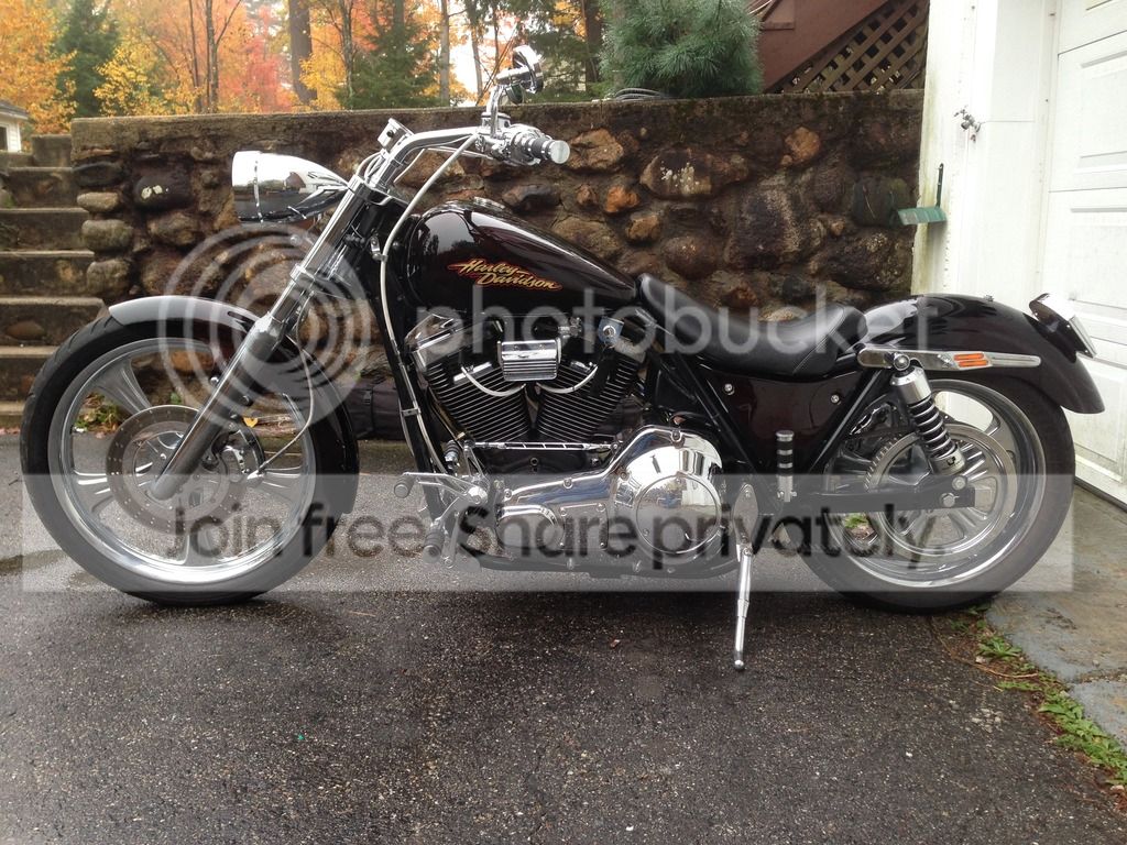

And in case the dog ever goes down again, I have this as a second bike. 1988 FXR with 22K on it for miles.
