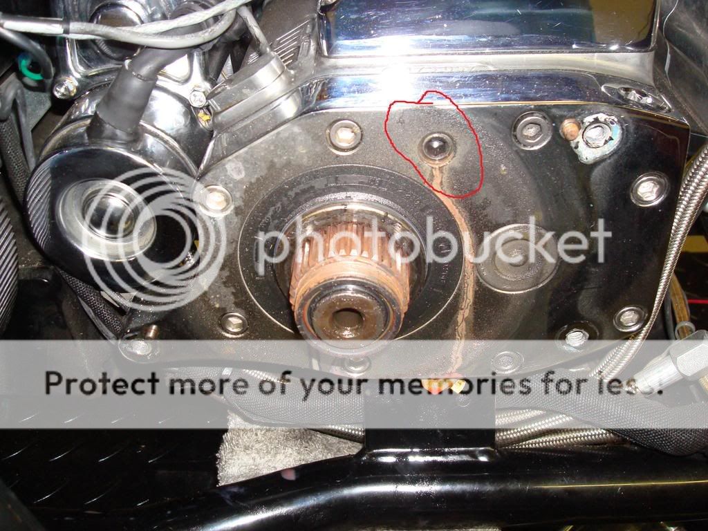

I used an impact wrench with trans in neutral and someone holding the rear brake. My bike was actually on a jack. Don't remember the socket size but 1 7/8 sounds right. This is what mine looked like.
Plug leak:
Plug leak:

So I have it all back together but too late to fire it up and go down the road, I hate that. Anyway, seal looked fine and it looked like the source of my leak was the same plug RRRuff mentioned. Mine wasn't leaking bad so it was harder to tell than in the pic RRRuff posted. I still believe that was it though. Pulled the plug out put some teflon tape on it and now I just need to let the Dog run out and we'll see. Should stop raining this weekend :2thumbs:
RRRUFF
Good deal, mine was the plug fixed that and about 3 months later seal started leaking. The original seal was hard and brittle replaced with new no problem now.
