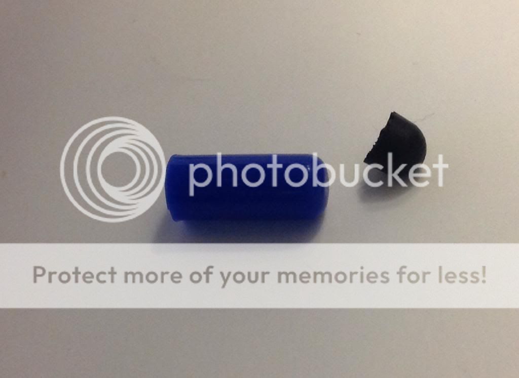

So getting bike ready for a small trip before winter, pup starts to pop, sputter when throttle from a stop, twist the wick hard would get through it. Timing stud broke about a month ago, thought static timing was off. Come to find out the vacuum caps are dry rot again. I just replaced them last year. Bought some high heat silicone ones, hope they last. Check your caps.
