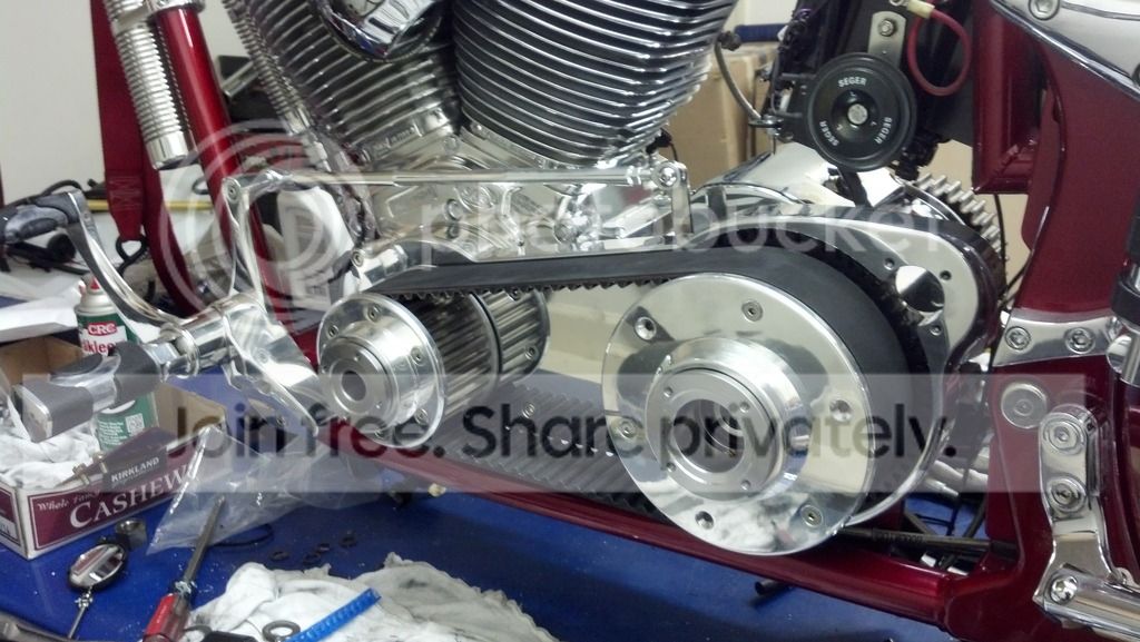

Was adjusting the clutch when I noticed a part with a broken bracket. When I first saw it I thought it was part of the ele. System. After pulling the bracket off I figured out it was some kind of little air pump. I'm assuming it's for air ride. The little plastic line had been cut or rubbed in two. Couldn't find a switch anywhere for it nor could I see where it went into the shock. I noticed there were two underneath the bike (one has loose bushings) but did not feel a valve anywhere. Anyone know what it is and ho to hook it up?image.jpg

I did a search but nothing really comes up (that I could find) about the individual components that are needed to make it work. As I said the line on mine was cut no gauge that I can see and I didn't find a valve on the shock to hook up the line.

image.jpg image.jpg The little black tube was the only air line coming out of the pump you can see in first pic. Second pic is broken bracket.

To answer a few questions the bike is a 2006 mastiff. Got under the bike and I can feel a valve anywhere. As I said before looks like the line was cut and possibly air shock swapped out. I seen one on the bay for 549.00 might think about going that route once I figure out if the pump works. I'm just one of those guys that does not like shituff unhooked that is not supposed to be. If I the there I want it to work and be installed correctly
