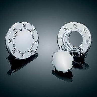

Here you go... Great! :2thumbs:
[ame=http://www.amazon.com/gp/product/B007KPWV3W/ref=oh_details_o00_s00_i00?ie=UTF8&psc=1]Amazon.com: Kuryakyn 8309 Vented Flush Mount Gas Cap For Screw In Tanks For Harley-Davidson: Automotive[/ame]
