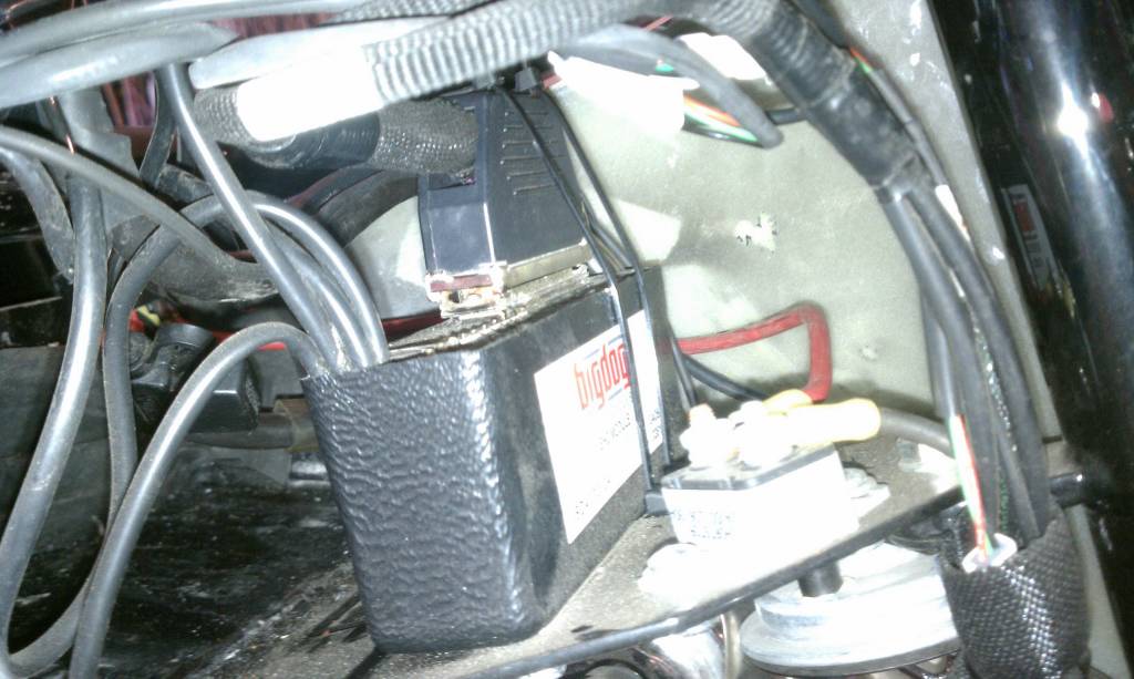

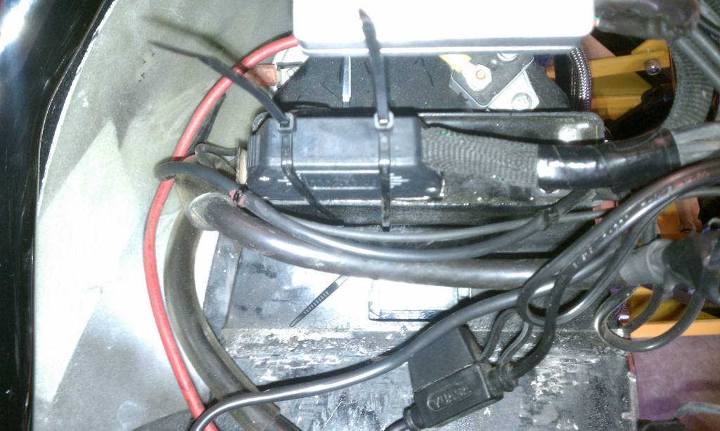

the 04 EHC also had a recall on the EHC harness it was their first attempt and it didn't lock down well.
Take you a minute to check it. When you turn the bike on in the garage and the Red power light comes on just stick your hand on the top of the EHC harness and just wiggle it a tad see if the power light on the module goes in and out. This is what happened to mine and they did provide a fix but it wasn't very good either and I zip tied it together and it held for the rest of the season then I replaced it all. But intermittently would start and run and sometimes go miles and sometimes can't get out the driveway took me a little while to track it down and that was also a Long time ago...lol
Take a pic of the harness and it's connection to the EHC we can tell you.
And I dug up pictures this is back in 2011...lol.
Here's a video too if the problem you can see the light go out from the vibration and just a little touch put it back on.
