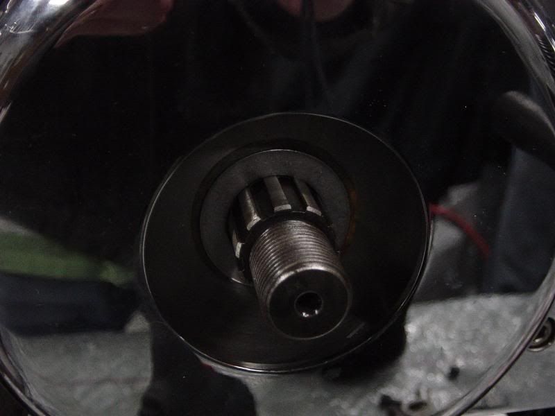

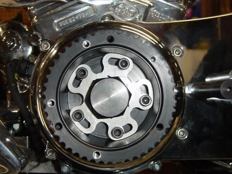

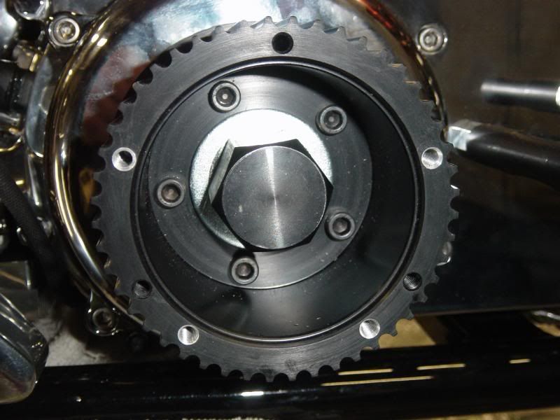

is 7/16 of spline enough to hold the front pulley on?

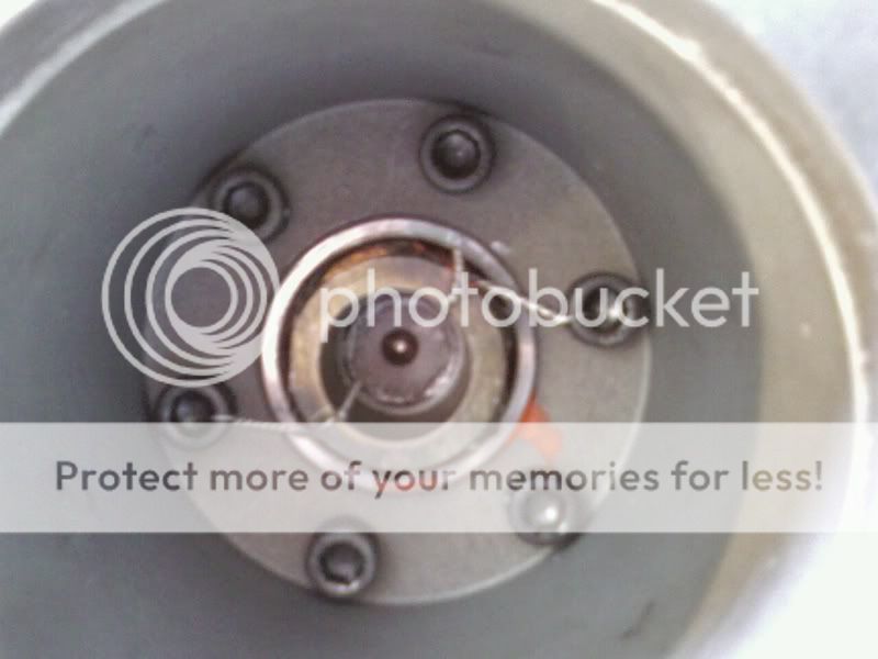

I've safety wired so much shit on rockets... its all about positive locking pull on the safety wire. As in the direction of the wire pull should be to tighten the nut or bolt.
