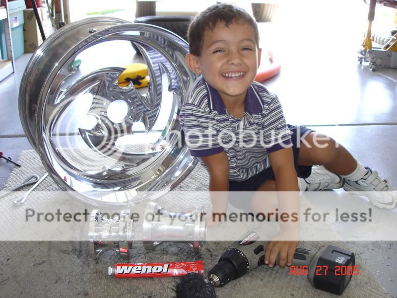

Damn Rowdy, bust out the drill and polishes and get hot! :job:
If you have a little helper give to him and he will do it. It's not that hard. :D

rowdy13
thats the stuff I should use......Weenieol. did it take the scratches out, or did it make more???
