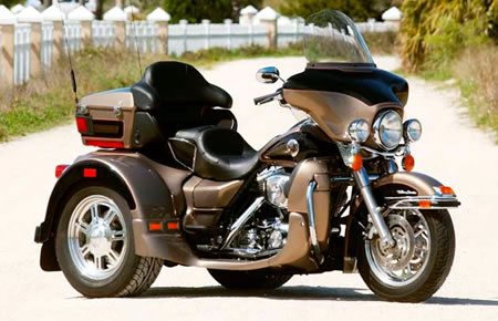

We just triked out dad's '05 Ultra Classic with a Lehman Trike Kit. It was done by the good folks out at M&J in Martinsburg WV.
His bike is identical to the '05 pictured below:
He's added a few pounds to the machine with the driveshaft and the extra wheel. The trike kit also extended the length of his exhaust by at lease a foot.
Because of all of this the bike bogs down a bit sooner and the check engine light floats on occasionally. Unfortunately he can't just rejet and move on. He's got Fuel Injection.
