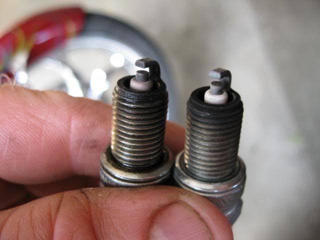

When do you use 6th gear? I am running on two lane country roads always on the look out for cops, deer, elk, bear, turkeys and assorted varmints so I never go much over 60 mph. At 55-60 I have to run in 5th gear or the K9 seems like it is "lugging" in 6th. Is this normal or is there a problem with the carb adjustment air bleed or jets? The bike runs excellent as long as I am above 2000 rpm in 5-6 gear but in 6 that is going too fast. Last time I was on a 4 lane running 70 in 6th everything was fine. Always thinking I need to adjust the carb.
How do my plugs look? Front/Back cyl.

I'm curious about the plugs. Don't they look like it's running lean? No. Today's engine runs lean [is mean]. Less carbon, less emissions, etc. To read a plug, look all the way down at the bottom where porcelain meets metal.
Gray = Racing
White = Normal street emissions
Brown = Rich torque [wink-wink]
Black = Oh shit we have a problem.
Not good. Look at the left plug. We see the shinny oil around the end of the plug? Now, do we see it follow up the threads and oil out the hole? See how dry the white plug is thread wise?
