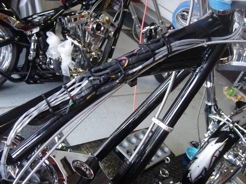

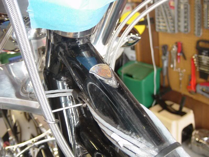

I had an electrical issue in which I had to remove my tank and found the bottom tank mounting bracket was in place but cracked at the bends.
