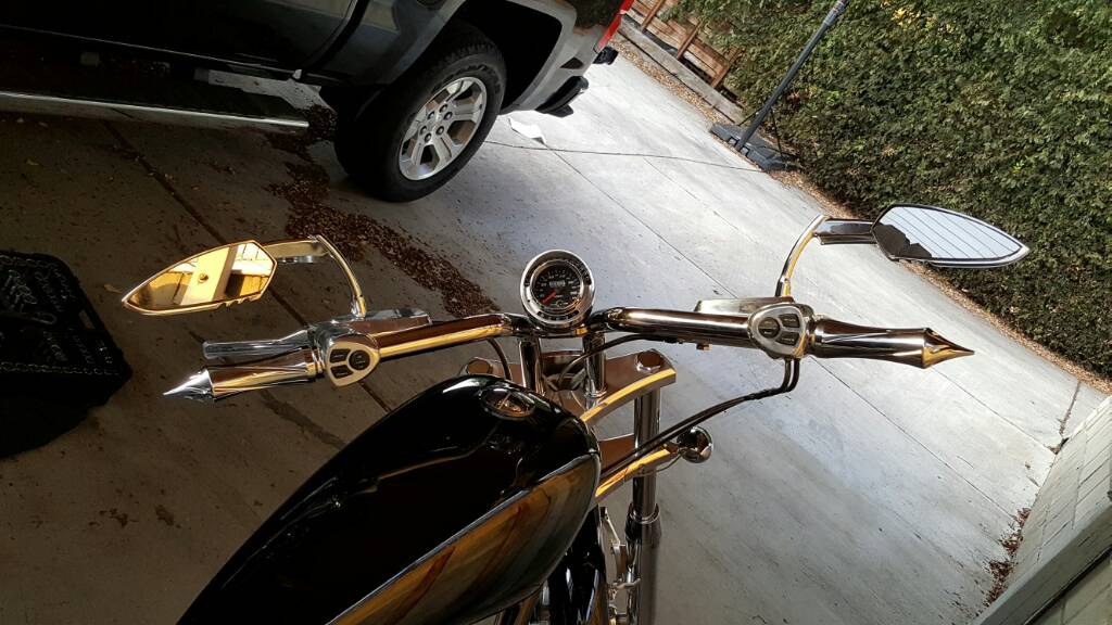

So another stupid question probably in a series of stupid questions. I've been looking at different gas caps and been reading threads on paint savers. I have a very small section of paint beginning to bubble around my gas cap.
My cap just screws directly into the gas tank clockwise. I don't have a metal ring around the threads. Did the previous owner already remove the paint saver or am I confused to what it actually is / like.
It's a 2008 Mutt.

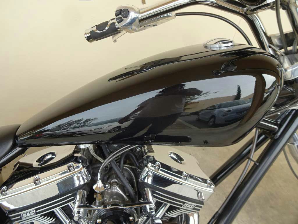

Difficult to tell unless you post a photo with the cap unscrewed and off; then we can see insert.
Big Dogs use the Landmark gas cap with paint saver. (All inclusive in the packageing if you were to buy it new from Landmark)
I had to redo mine because of incorrect installation after new paint; paint bubbles appeared immediately -- never spilled a drop of gas...
Long story short -- best fix was to put "Mr. Wright's" custom made oversize paint saver ring on underneath the standard Landmark paint saver ring and RTV silicone seal.
I will post a how to thread with photos.
Just been busy but know very well of this problem and the FIX !
Upper part of photo shows basic Landmark Gas Cap, Paint Saver.
Lower part of photo shows "Mr. Wrights" custom made Larger Paint Saver Ring
