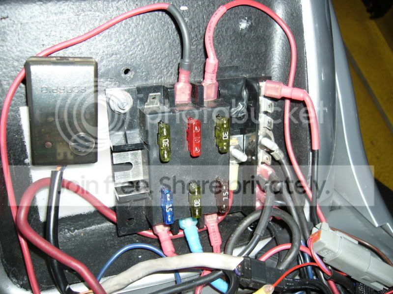

Been running a 2x3 block for the last year since I dumped the EHC....
