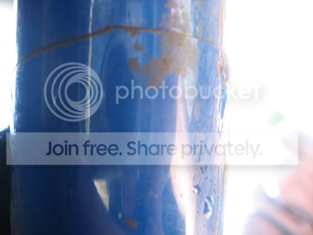

I have gone over my Ridgeback carefully also and no cracks visible. As hard as I have hit some potholes I worry a lot. But so far so good. I feel for you guys as a cracked frame is a pain in the ass to repair correctly.
So what is the process to repair a cracked frame?
If the frame manufacturer does swap the frame, who pays for the labor?

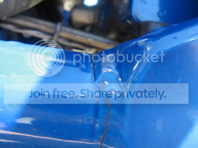

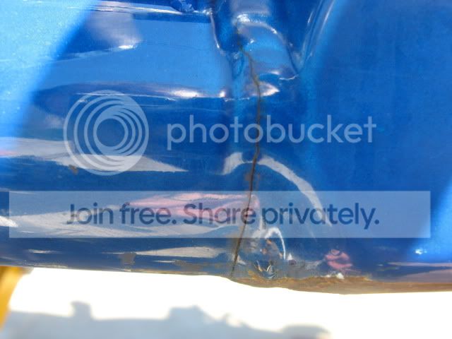

Sorry pic is blurry, but you understand the location. Its a hairline crack right in the weld. I have 46,000 miles on her and havent hit any real bad bumps over the years. I do understand I need to get this fixed, but I dont believe this would be an extreme load bearing area. Whats yr thoughts?
Coolbreezin
My friend explained my crack to his friend and was told that TIG isnt strong enough, plus I need to R&R the little horizontal pipe. However, to be fair, the welder hasnt seen my bike so his comment should taken with a grain of salt. Whats yalls thoughts?
bearman
...but I dont believe this would be an extreme load bearing area. Whats yr thoughts?
It's the part of the frame where the motor mount bolts to. So yes, it is an extreme load bearing part.
My friend ...was told that TIG isnt strong enough.... Whats yalls thoughts?
Anyone that would say that does not know what he is talking about. TIG is the best way to control heat when welding something that can be damaged by excessive heat (like a motorcycle frame).
The strength of a weld relies on how much penetration there is, the quality of the weld, and how much metal is put on the weld, NOT the weld process. There simply is no way to get a higher quality weld than TIG.

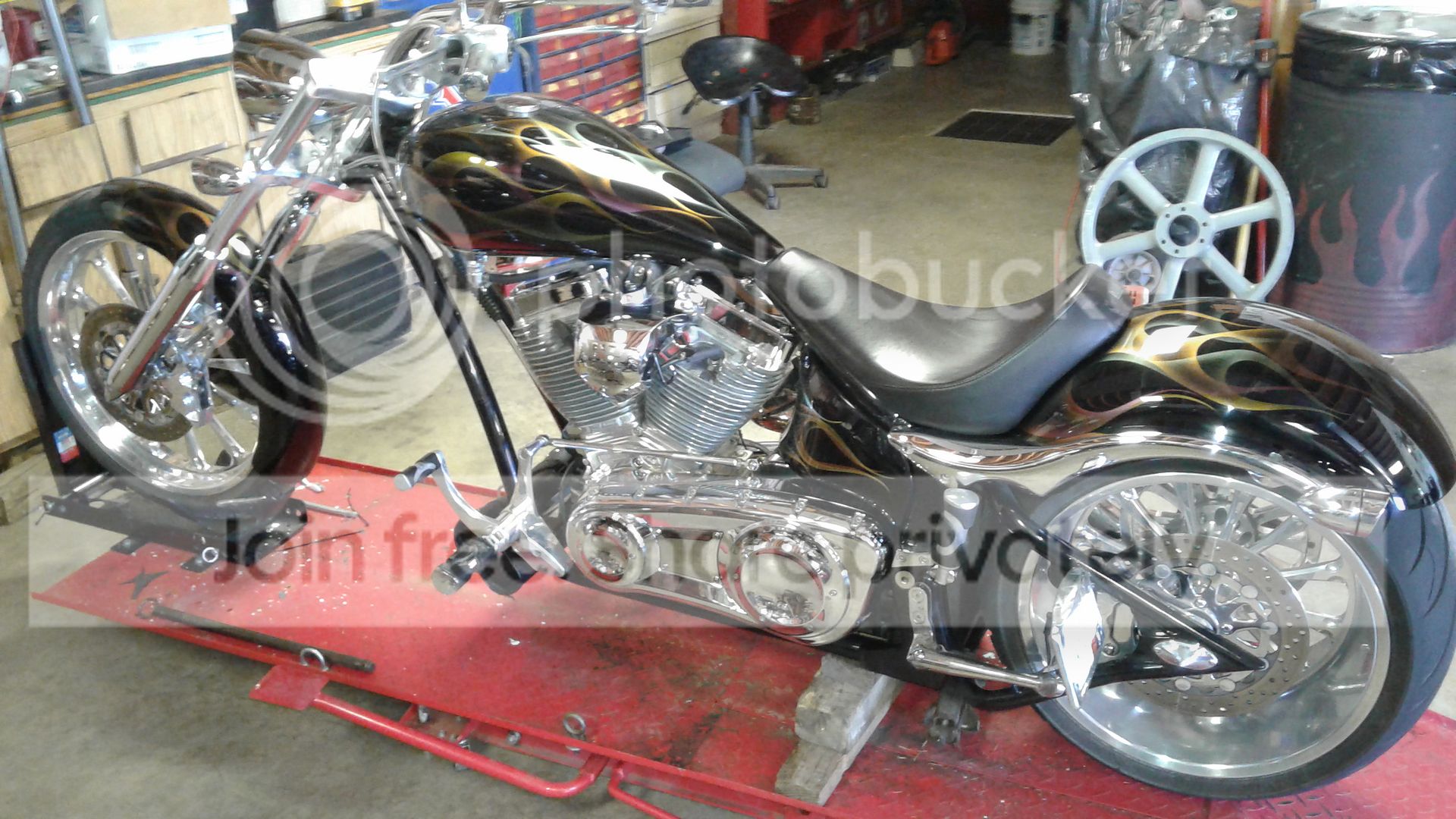

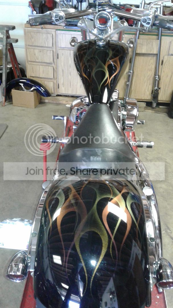

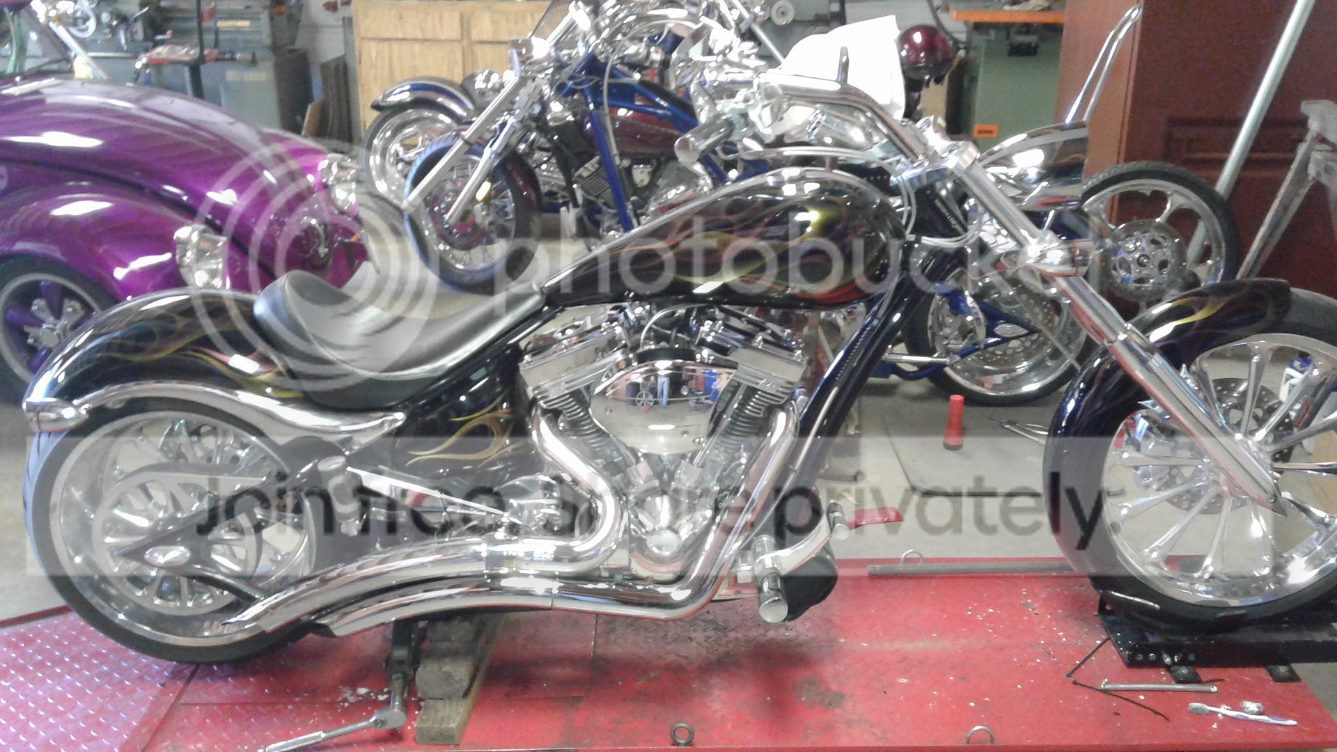

Looks like I just ran across one. 07 Mastiff. I was cleaning it up to replace a seal, and found it. It's only about an inch long.
Mr. Wright
Knows some things
Haven't done one, nor have I discussed it with the customer. Any an all input would be welcome.
That bike sure is dirty! Geeze even the boot is all ripped on the starter.
Your handy with a welder, although do you want to take on the liability? I guess it depends on the customer
At least it's black paint should be easy to touch up after.
Mr. Wright
Knows some things
Actually, it in really good shape. A few small paint flaws, nothing really bad. He just fill his primary up to just below the window, and it kind of reeked havoc on the trans seals. Hence the oil bath. Nothing major, just going to give her some love and send her out to run some more. I'm confidant enough with my welding ability, not to kill my customer.
