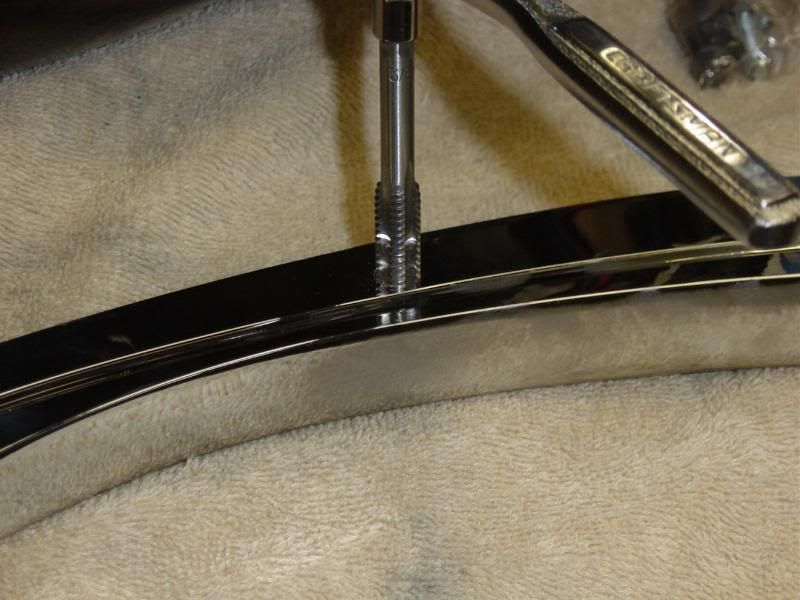

I also discovered another problem putting everything back together tonight. The main arm #24 has a bad internal thread for Screw #30 so I have to get a very small tap tomorrow and see if I can fix it.
Also the 3 small Screws #30 for the left control are a weird size allen wrench. It appears to be a 3.5mm. Neither 3mm,4mm or 1/8" work
Anyone else confirm this? I'm going to replace these tomorrow too.
I don't know about wierd size allens. Everything on the dog is standard coarse sizes. And chasing out threaded holes after chrome is VERY common. Done that with BDM and browns.
TCALZ06
I agree the holes could or should be chased after the chrome but the threads are damaged and not because there is chrome in them
