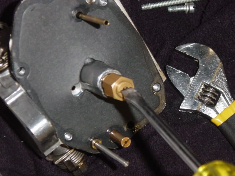

Here's what the bottom of the carb will look like (right) and the bowl (left).
Just be carefull to watch for the little o-ring (the little blue thing you see) that goes on the nozzle. It can get caught on the paper gasket and get stuck up there like this pic below. If it does, simply retrieve it by grabbing it or remove the paper gasket carefully by sliding downward and then put the paper gasket back, unless you plan on pulling the jets as described below.
Then since you're in there... check your jets if for nothing else so you know what you have in there..
Intermidiate jet
Main jet
Intermidiate jet
Main jet
Intermidiate jet
Main jet
