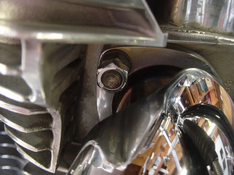

Last week I noticed I was missing not one but 2 flange nuts on my exhaust. I was just telling Alhall that I was thinking about double nutting them... then no more than 45mins later we noticed 2 of them gone... :down:
So I got some new flange nuts and some standard nuts...
Torqued on the first nuts to the flanges... then installed the second jam nut.
The studs are 5/16-24 for the nut size.
On my bike

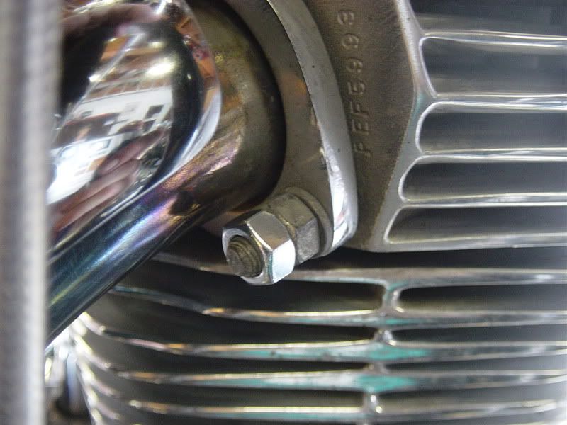

On Chopper Dave's V&H BR

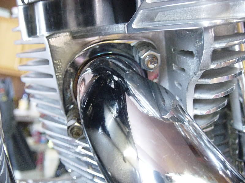

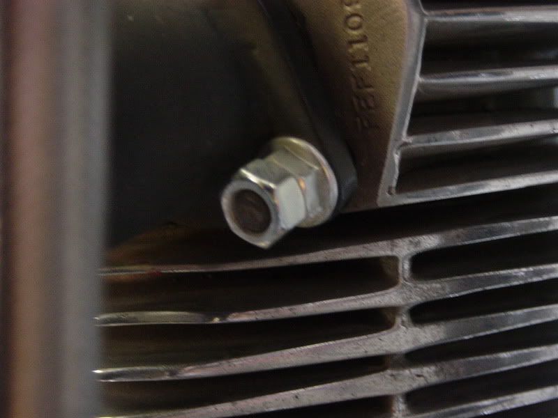

I did this on T-Mack's as well last weekend.
I think its a simple thing to add that has no negative and all the positives of a great preventative maintance measure.
