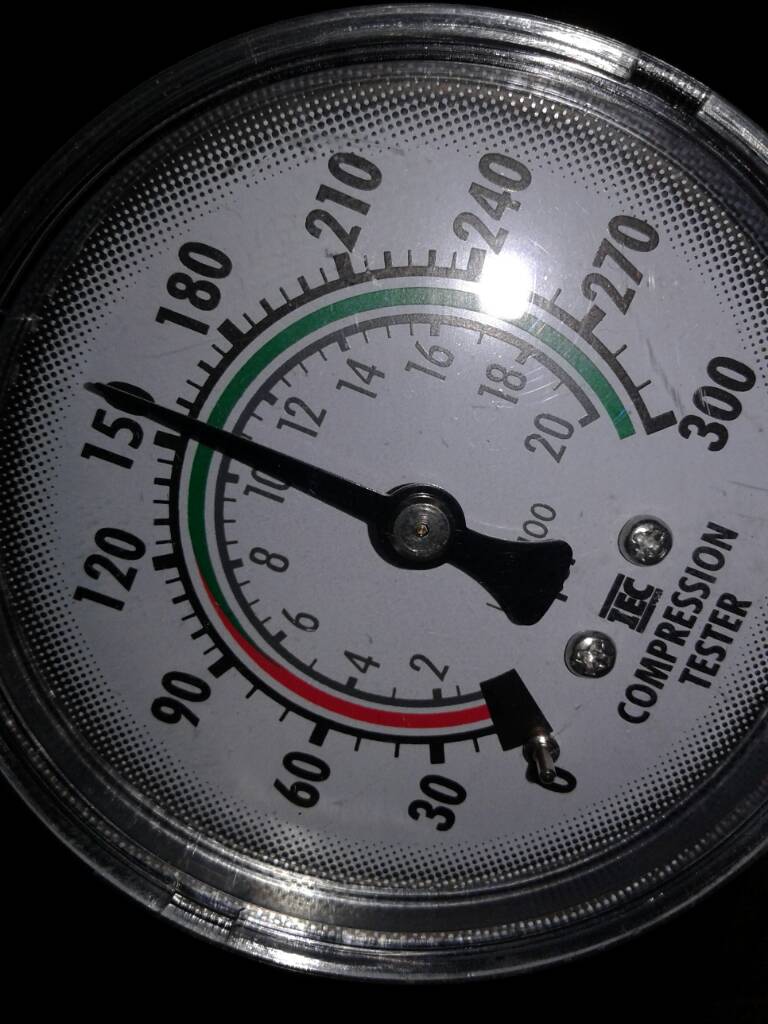

From the quick test I did today compared to last night when I parked it, it looks to me as I have a heat related component failure. So I'm goping to review what I did and maybe even swap back some parts that were not "failing" apparently (did some preventative things given age - new coil, new wires etc).
Last night front cylinder was not firing as well as it should have -- exhaust not as hot and not as forceful as rear.
Startup today and it was, still a little troublesome, acting like a low idle.
I'll tear into it later.
