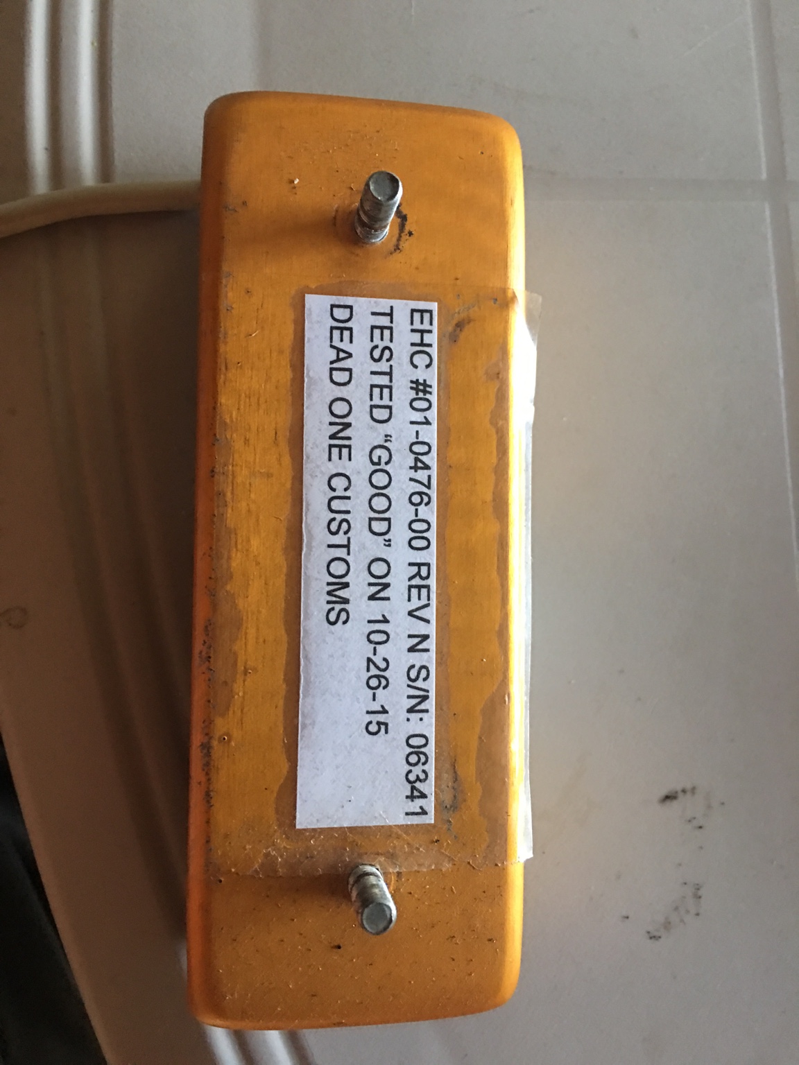

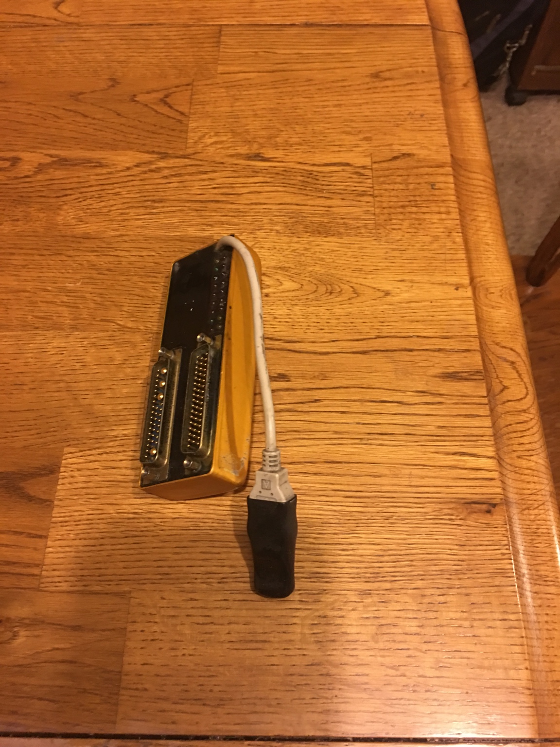

This is mine off my '05 Mastiff that Jeff at Dead One Customs tested good. I replaced it with his ESC.... So I am willing to sell it if you're interested.

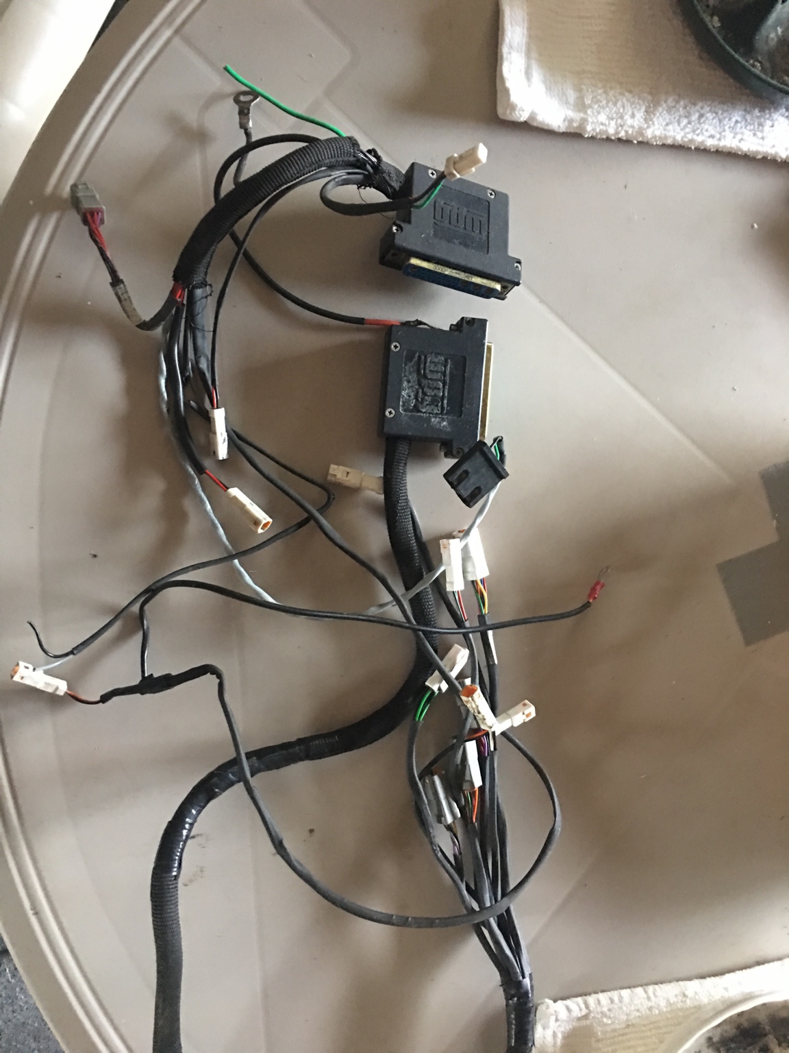

I have an extra entire wiring harness I may be willing to part with also, I believe it's off a '07 Pitbull but I can't remember for sure.
The original one off my '05 Mastiff was previously kind of "bastardized" so I am going to hang onto that just in case.

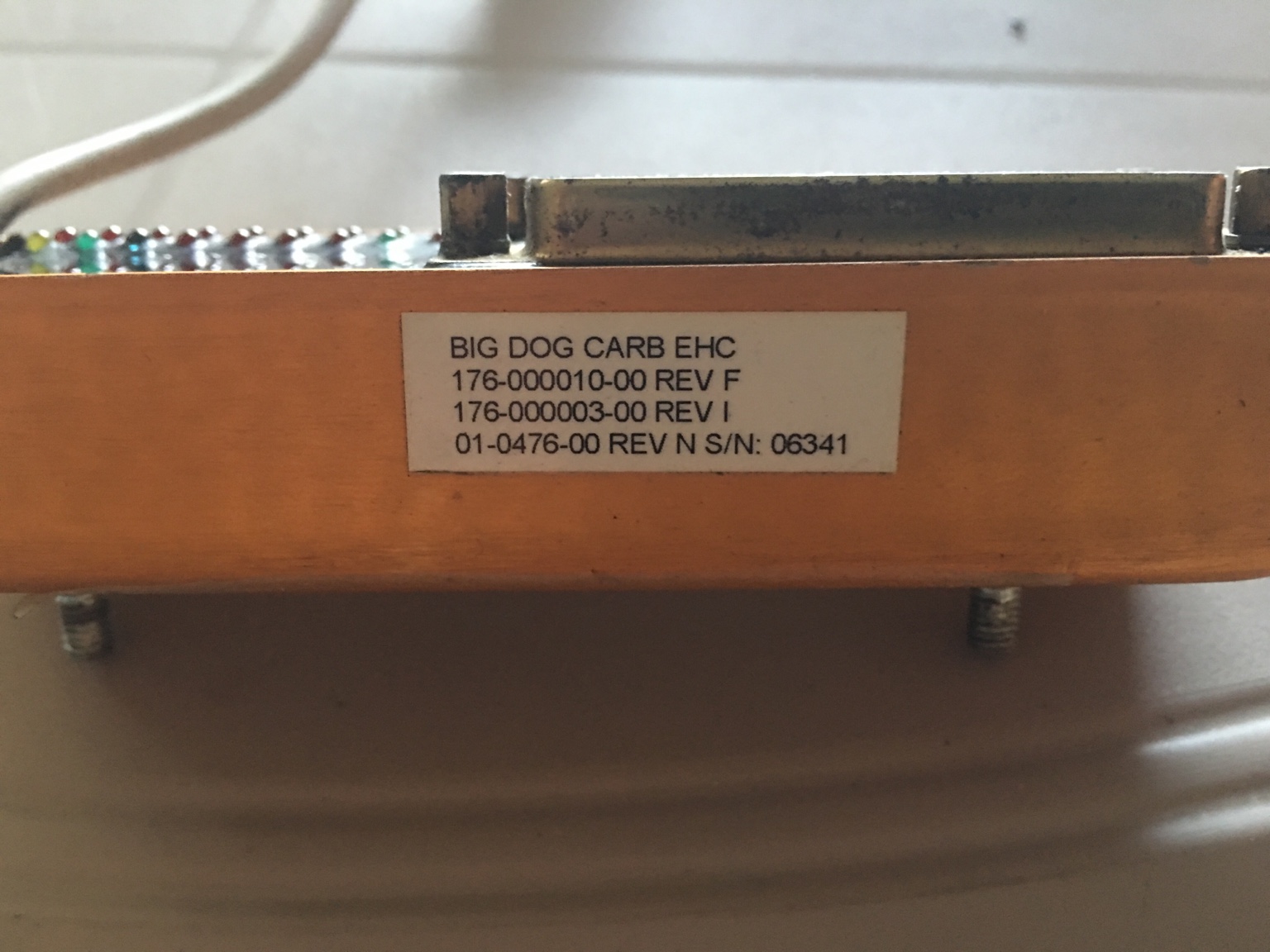

If this will work is gladly take it from your hands! He numbers don't match. It will take someone more knowledgeable than myself to know if it's interchangeable or not. And thanks for all the info guys I appreciate it!
Pappa B
Here is the one I have with broken prongs which I believe are grounds causing the pitbull not to engage the starter completely. Hope this helps making the decision if they are interchangeable or not.

I would call Jeff at DOC, but I believe it will work. He and Curtis at Wild Steed Worx are very knowledgeable and can tell you for sure.

The ignition switch hmm. Did this make a clicking sound like the starter solenoid was out? This may be my issue aswell. My thought was the EHC prongs were broke off and not allowing it to ground. From the pic you posted they are an exact match excluding the lights. It seems yours has 18 lights mine has 14.
