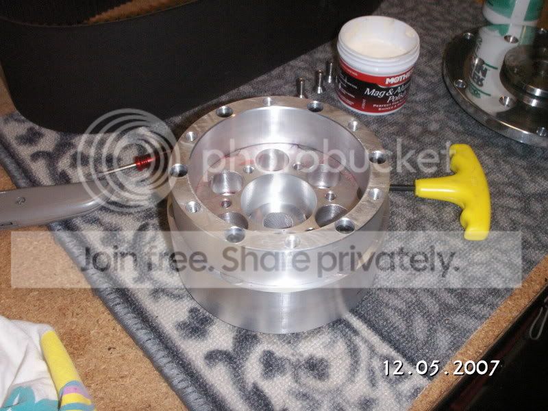

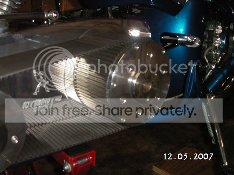

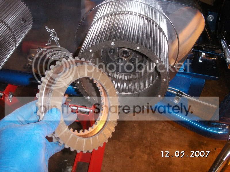

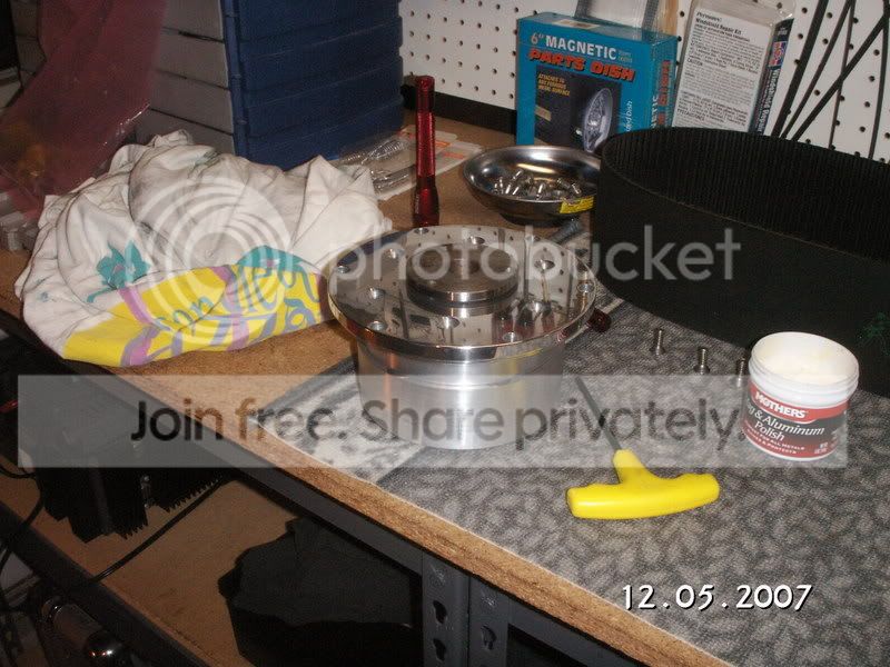

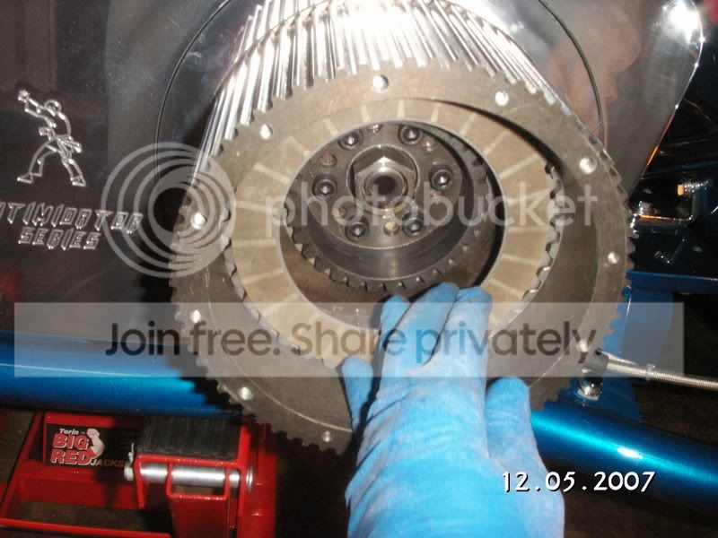

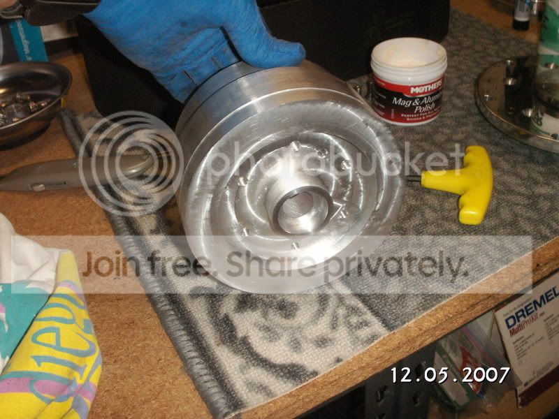

Well I just finish installing the EFM Auto clutch machined for the Karata 4" intimidator primary for the big dogs. I bought this to have the easiest zero pull clutch lever possible along with the holding power. I just got it together and took it for a spin..wow nice! I now have to get use to trying to shift without using the clutch lever(this is going to be the tough part) but for now I'm using the lever as normal but with zero pull and when I'm at a stop light I"m not using the lever at all and while in first gear I accelerate as usual and she takes off nice and easy. here some picks. note: Clutch pressure plate was machined to mount to the karata support plate as to the old pressure plate that was mounted to inner basket.
efm auto clutch
otherside

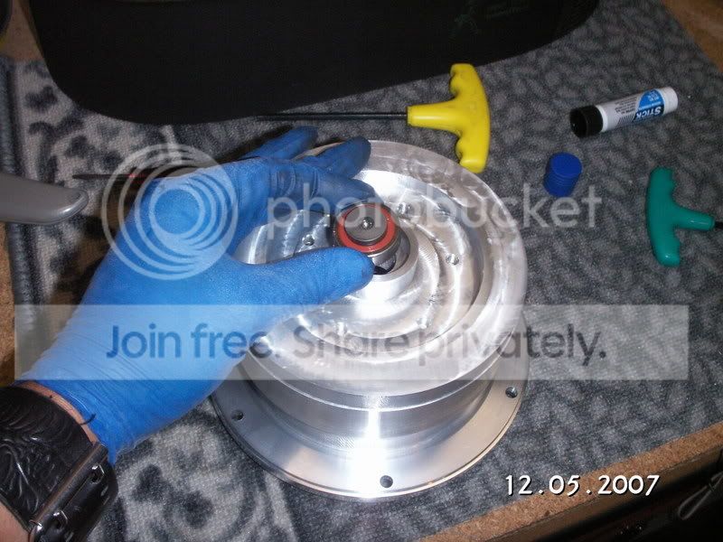

mounting outer support bearging to efm clutch
installing plates

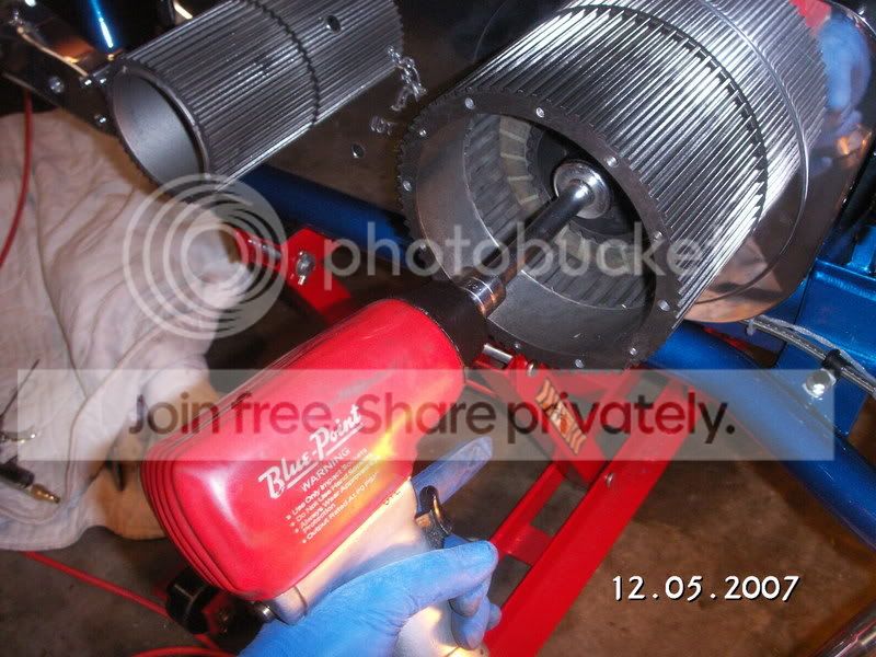

tightening basket
finished product except for the support due to adjustments that my be needed.
