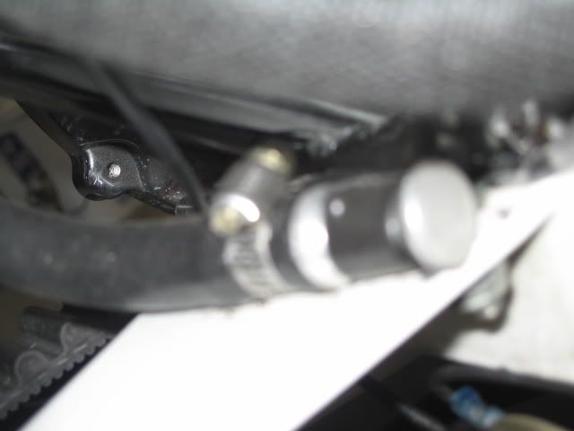

I want to learn to change my own oil and don't see any drain plug other than at the bottom of the crankcase. This plug does not release a lot of oil as most of it sits in the oil tank.
I can not see or feel any kind of drain plug/valve on the oil tank.
Should I just remove the supply lines?
The tank, as it sits in the frame, is leaned back a bit so how would you get all the oil out from the far "corners" of the oil bag?
I feel stupid for asking but figured I'm overlooking something very simple (hate when that happens!) :)
Thanks.
CCRainman
Look for a hose at the bottom of your oil bag with a plug on it. That should be your drain hose. It'll look something like this.
If not then you need to remove 1 of your oil lines from the bag.

My 2000 Husky has a hose exactly like the photo in above, and my 86 Softail was also the same, maybe its tucked up just under the tank??
