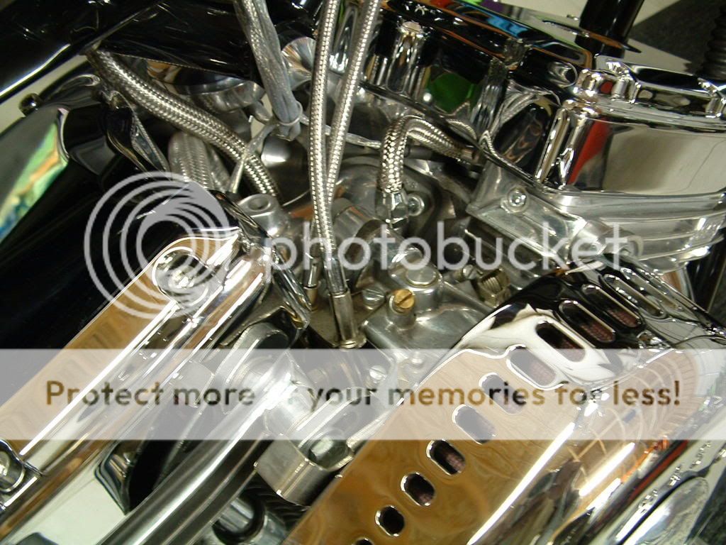

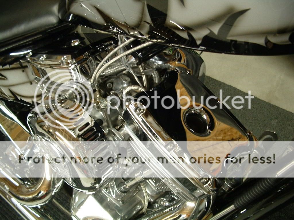

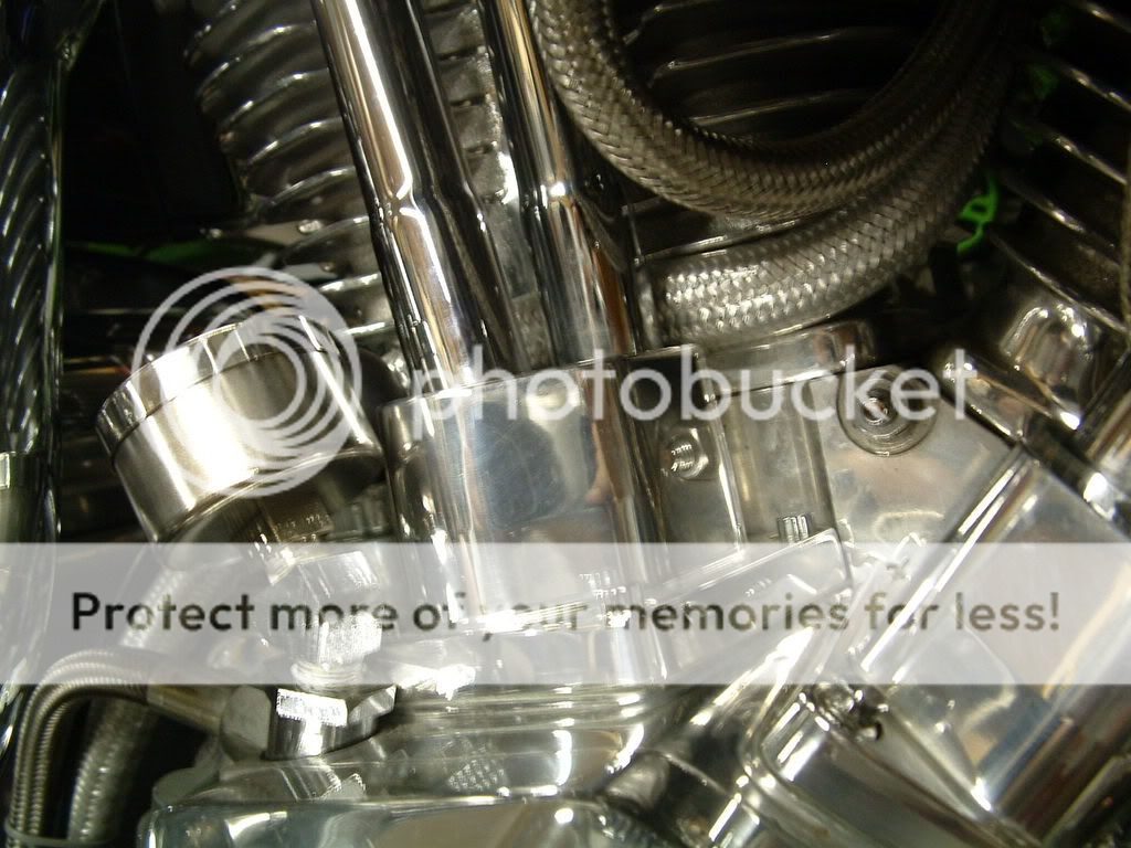

actually when my bike was at my dealer...Doc(the tech) plugged the breather fitting in the backing plate and ran it down....with the check valve to the ground...hold on...I will run out and take some pics...I did the front breather line and the sleeve for the 1/8 carb drain line...
Chopper Dave
SIICK!!!
ok..here is how mine is run...
and check valve at the bottom of bike...
