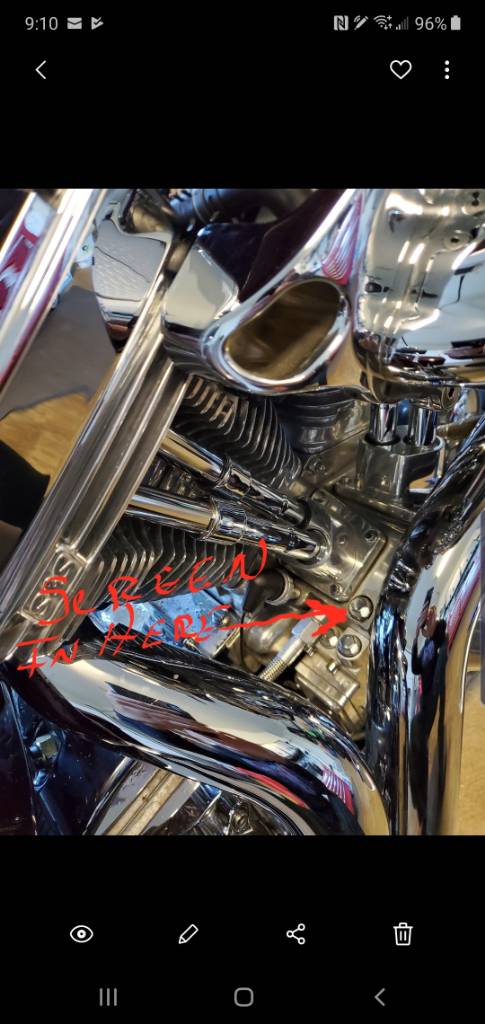

I installed a Tappet Screen gauge and fired it up. The gauge didn't budge...nothing. I quickly put my ear to the rocker box and could hear a Tap-Tap noise. Sounded exactly like a car sounds when running low on oil. I don't feel confident enough to perform the pump rebuild/replacement, particularly when a mistake could do significant damage. No idea at this point if damage has already occurred. I plan to drain the oil and have a look. Regardless of what I find, I've located a shop that has a good reputation and I plan to take it out to him when he can schedule me in. Thanks for your help.

I can think of 3 oil checks right off the tip of my [burns when I pee] but that's another story. Wire coat hanger and bend a hook so the pushrod tube is held up and stays there. Rear exhaust looks the easiest. Start the engine and if you see oil pepper out of there, kill the engine. Remove the timing plug at the lower engine case, start the engine. If oil heavily sprays out of there, kill the engine. Remove oil gauge, clean threads with a wooden toothpick chasing thread tape or whatever; start engine to purge debris and oh look, oil shot out of there is 3 ways of finding if the pump is operating as per.
Post 8 says the keyway dropped out and no pressure. No blue mist 12, no 'splash lube' to the piston skirts. This galls the aluminum to the cylinder walls and sort of snowballs material off the thrust sides of the piston. This opens a normally tight clearance so you do not have this slap-slap, or tick-tick being the change in direction from top to bottom skirts = Ticking.
So the deal is... slide the rear exhaust push rod tube up and light off the bike. Brake clean the tube clean at the bottom before you pull the C-clip. And it takes no tools to remove that C-clip. Just grab the bottom of the C ends, pull down on the little cap, grab the C-clip out at the bottom.
If you hear the ticking and no oil out of the lifter, then yeah, skirts might be damaged causing the tick.
Here is a flow chart. Top end receives oil first =1-2-3-4-5, then 6 [spring] is overridden via 2A's main pump; feed's 7 to the bottom end.
