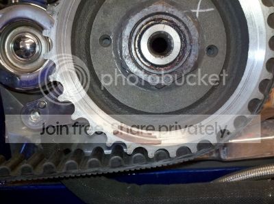

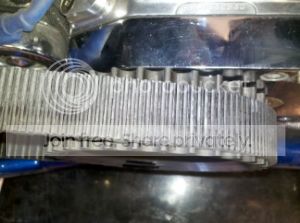

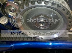

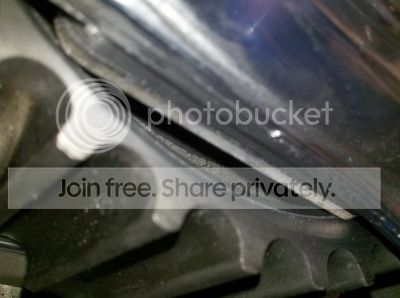

Here is some pics of my 32 tooth pulley setup.
Yes the outer flange has to be machined off. There is no machine work that has to be done on the transmission side of the pulley. You also have to use a harley "star type" locking plate on the pulley nut. The pictures above is not the finished product, just the first test fit after machining. I marked the pulley with a black marker and turned the wheel over to get an idea where the interference would be. Then I took it back to the machinist and had him whittle some more on it. :up: I did take just a little metal off of the cover plate for the clutch actuator assembly with a die grinder, just for an extra hair of clearance. It works great!
