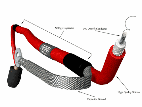

On my 03 and Kaptain America's 03 when we put on other wires the electrics did wierd things. So we had to go back to the originals. On my 05 I run the Nology wires with the ground wire and they work great. I picked them up when I lived in Kalifornia, I lived just a couple miles from this place.
I got them in Yellow!!!
Nology HotWires Spark Plug Wires Ignition Wires Manufacturer
