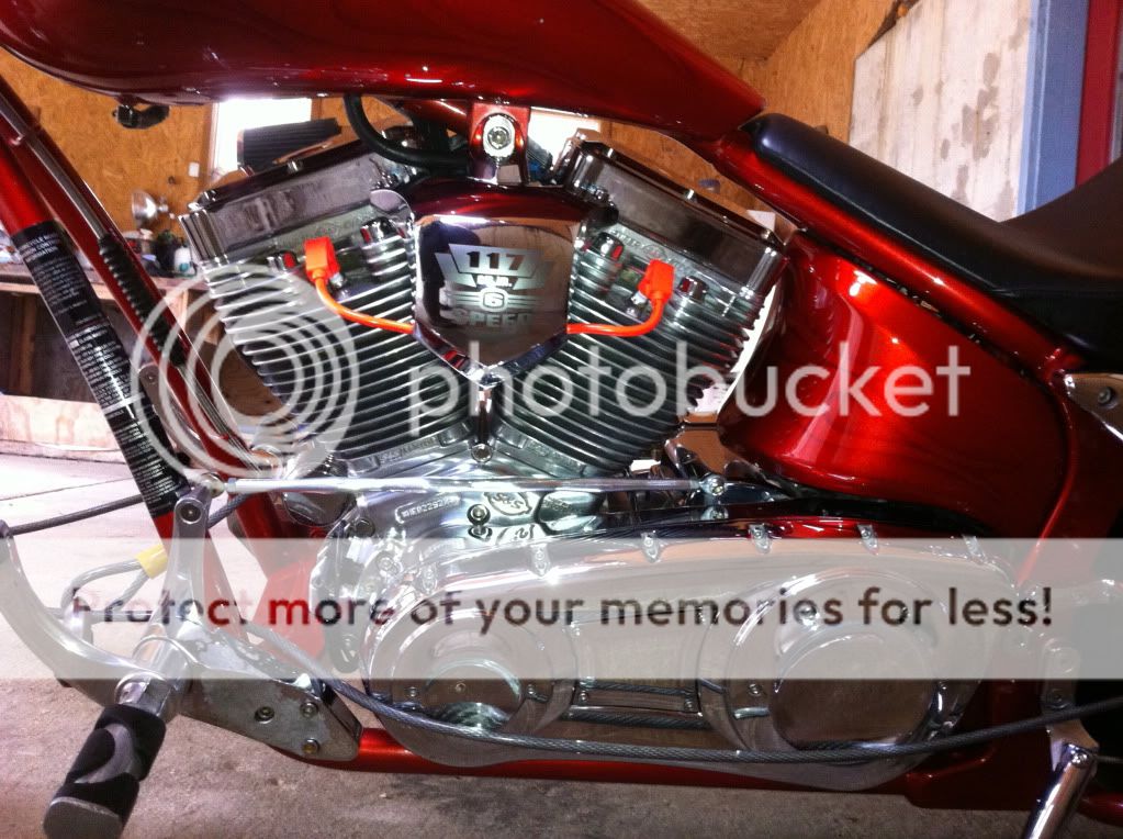

Well first off looks good!!
But man you got that dog TIED down!! I have mine on a leash but just through the back wheel, and I cemented in a couple eye hooks into the floor. You got that thing wrapped all the way around? Have you been broken into before?

Firstly, yup, the down tube stickers are gone lol. 2 under the seat and one with the inspection sticker and license info. Does look alot cleaner Ill admit.
We were staying out in the country at relatives. Id only had the bike a cpl weeks so was very anal about things with it. Was imagining someone lifting the garage door and rolling it away. I can remember in school (long time ago) when a kids bike would get stolen. "They'd" take the bike and leave the locked front wheel in the bike rack. Then steal a front wheel off another one. Tadaa!! New bike.:up:
So I run a cable through both wheels and the frame. Anyways, I'm OCD when it comes to security (job related I guess). Also, I try to think "how would I steal that"? Then adjust accordingly.:2thumbs:
I sleep better lol.

I hear ya! Ya I was originally going to mount the hooks in the front of the garage to go through the front tire, but I was on the same thought process removing a front wheel doesn't take much. A back wheel is a much more difficult and time consuming process. I keep the back tied down and the front has a Xena Disc lock with an Alarm. I'm sure its overkill while its sitting in the garage but it helps me sleep and I don't worry about it when I'm not around. :up:

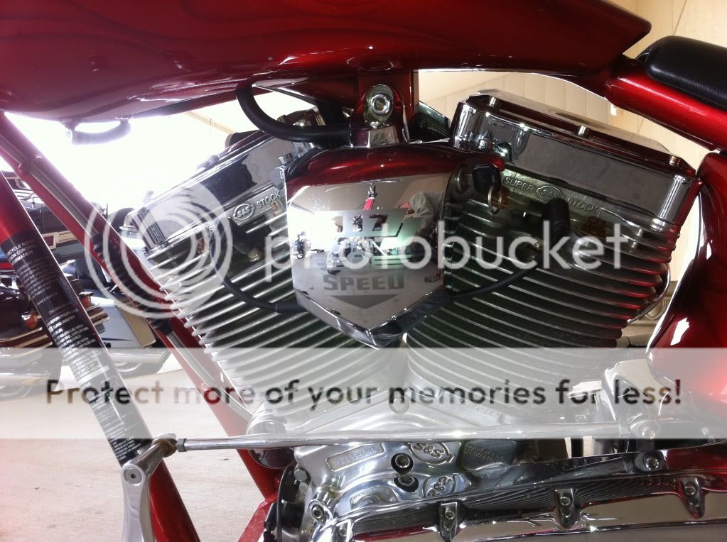

What product or method have you all found to clean and restore the engine to look decent? In particular I am having trouble getting into the fin area on the jugs and the nooks and crannies. I have ordered one of these polishing kits off of ebay. Has anyone tried it?
