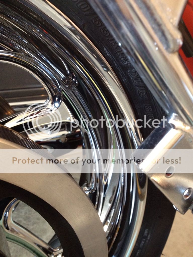

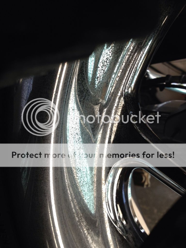

This is a before and after of my friends Roadglide, first I tried Mothers chrome polish, it didn't work at all on the corrosion, neither did White Diamond. What did work was Turtle wax chrome and rust remover, that removed 85% of the corrosion, Then I took Happich semi chrome polish and that removed most of the fine pitting. I was suprised that the wheel cleaned up that well.
