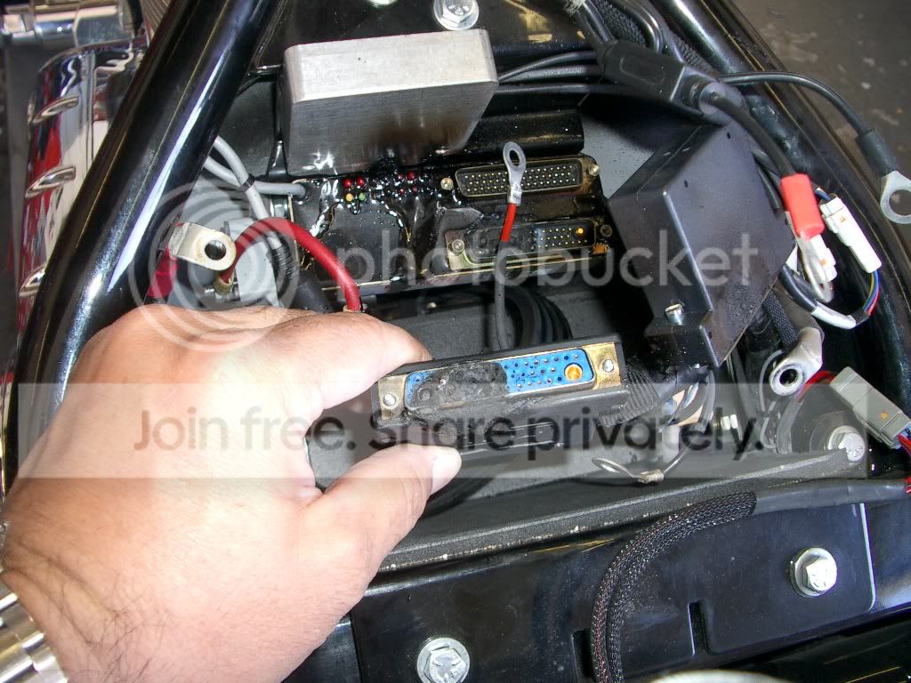

2005 Chopper, I was riding down the road, and all the lights started flashing, starter engaged, engine quit. When I took out the EHC I found this:

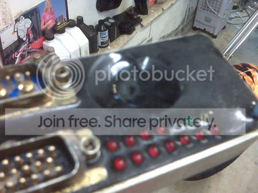

Sorry for the blurry pic, but a piece of the epoxy is actually blown out and there is a pin sticking out down there, I'm not sure if it got red hot or something actually blew up. There are no signs of melting.

Maybe your "luck" is changing for the better now! No fire! Did you hear it pop at all? It should have been pretty loud as big as that "divit" is. It looks like a replacement EHC. But what I'm wondering is which revision? Whats the part # on that one?
Moe, I've had one melt down and it even burned a hole in the battery. But I haven't seen one just break but I would guess that one of the bolts on the back probably broke and caused the breakage there. Check the back of the EHC and see if the two lugs are still welded on.
Here's mine when it burned up back in 04 that lead to the resister pigtail in the ignition switch on the 05's.
Moespeeds
Bolts on the back were intact and tight. There is a little charred pin down in there, right at ground zero. I'll get a better pic up later. I also lost the positive battery lead, snapped off and I can't figure out why. The new battery was a little too tall but I cut two very large holes in the seat pan to accomodate it, there is no way it was rubbing.

My 05 did a similar thing but enough smoke poured out of the hole in the potting (epoxy) it looked like a smoke bomb. If I didn't happen to have a 10mm wrench to disconnect the battery, well who knows.
