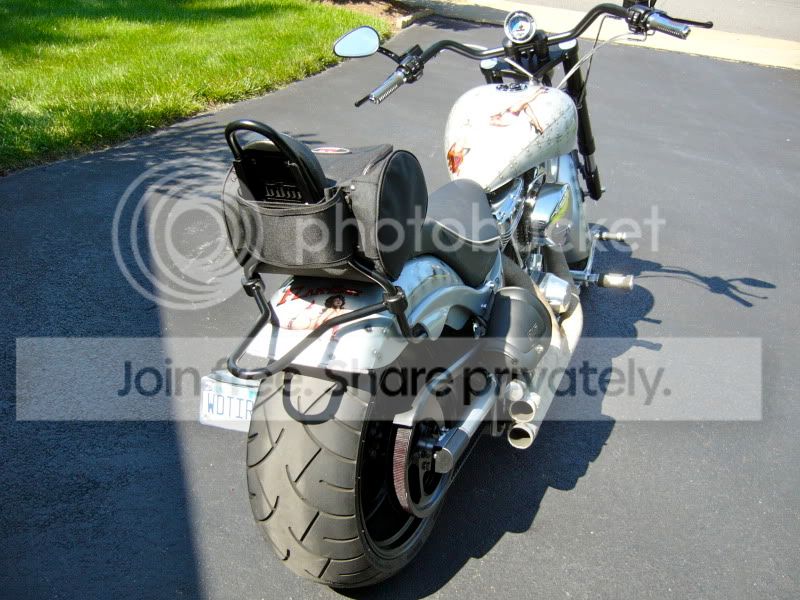

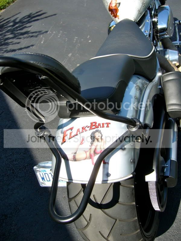

I am assuming the strip on the rear fender is your brake light.
Is it your signals, too?
What about the front signals?
Or are you not running them?

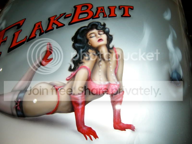

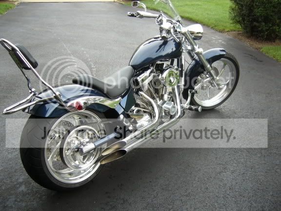

cha cha i love the way you cant even see the resemblance of the bike of how it was and how it is now.....

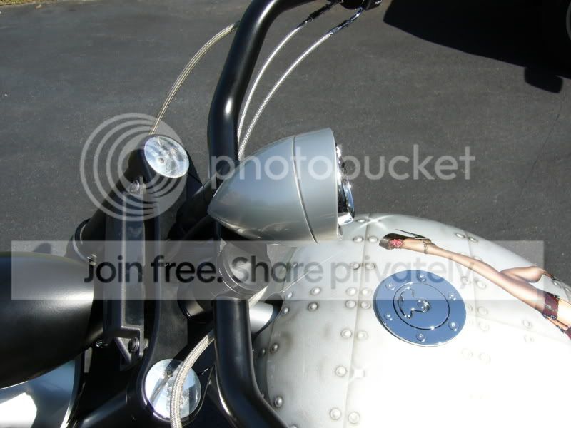

Bike looks great. Did you ditch the BD electrical or somehow fit the BD switches to those bars? I can't tell from the pics. Also who's front end?

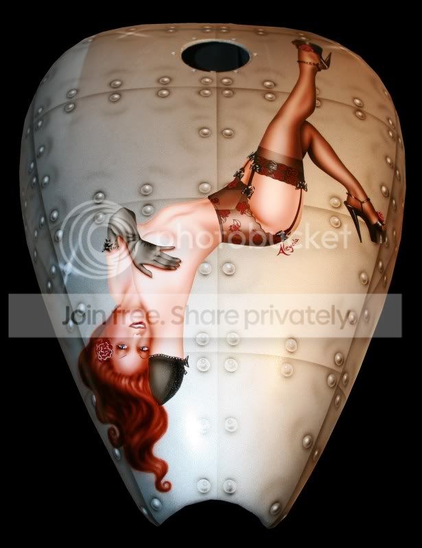

Nice transformation chacha. I really like the pin up girls.

For Alhall and the others that asked about the electrical;

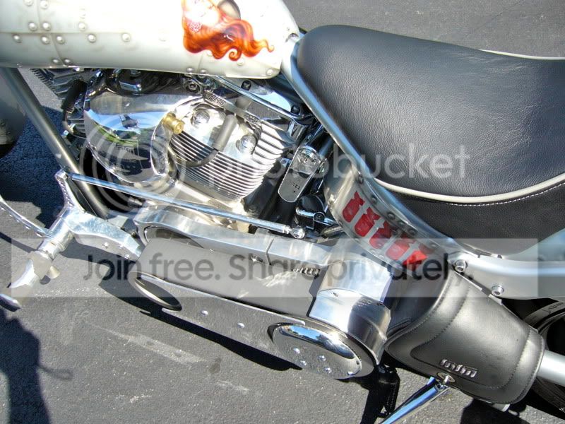

I went with the Wire-Plus Post Mount Chopper harness and ditched nearly all of the BDM electronics -- all that is left is the LED lights to the license frame and the two sensors for the tach and the Speedo!
I ditched the bars and the switches cause--to be honest--if I make a change, I tend to do it all at one time. The Wire-Plus product has been great so far and their tech support is excellent (even if there directions are not). I think BDMridgeback's Wire-Plus solution to keep the BDM switches is a fine option and we know he's worked out all the bugs himself -- it just wasn't where I was going.
I chaffed the frog-eye signals (just really never liked that look) and LEDed the whole thing. Forward signals/running lights are from Custom Dynamics and made for the Victory Hammer -- only 2mm too big of the ID for my frontend so made shim rings to fit them up nice. The front-end is the same OEM one, just powdercoated flat black like the wheels.
Wrap-Around LED Billet Fork Clamps
The rear strip is made by Radiantz lighting and is a dual LED flexstrip riding on an aluminum form bonded to the inside of the read fender.
Radiantz LED Lighting - Toll Free 877-469-4241
