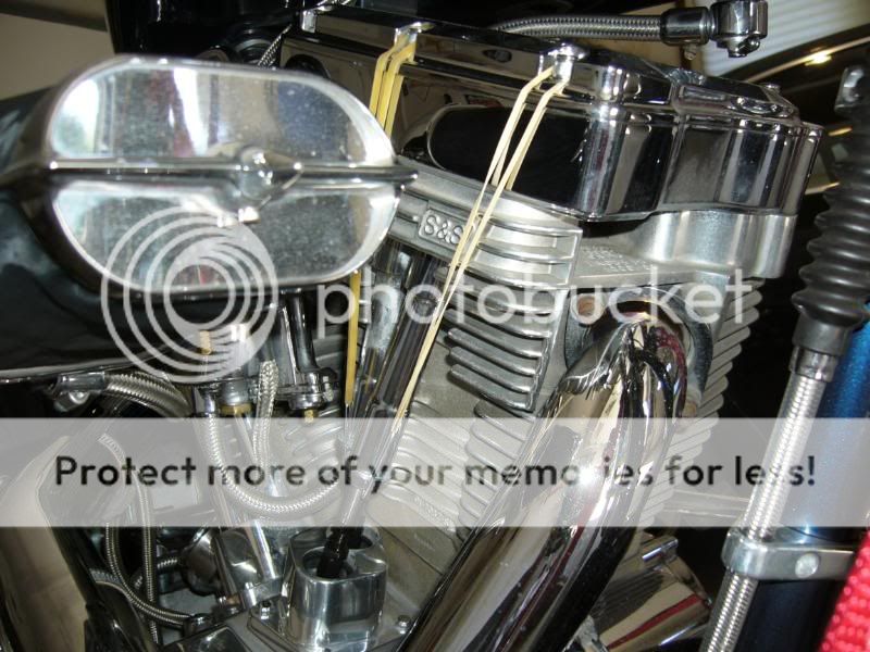

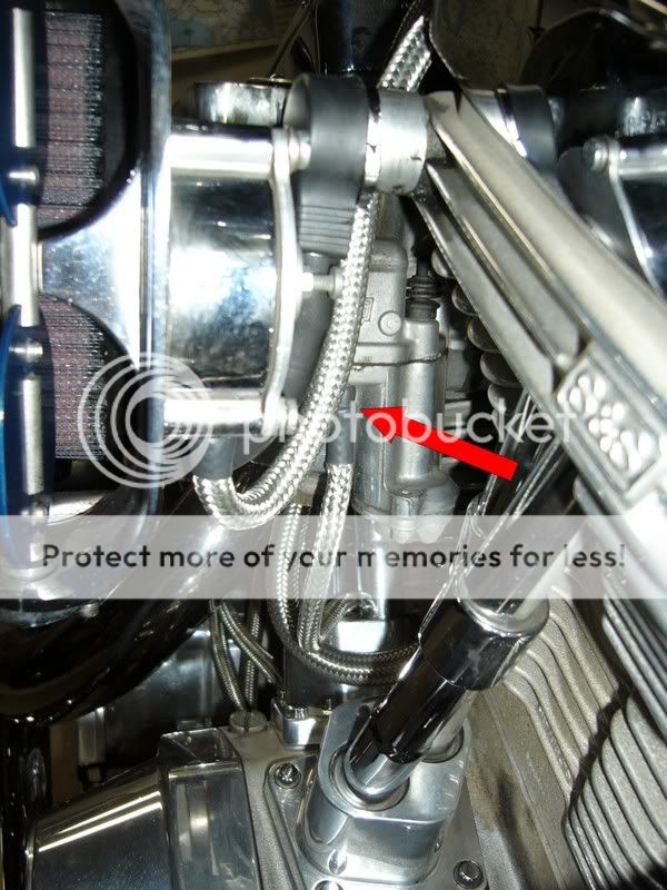

go to wimmer.com they sell breathers you can mount to the breather bolts from the head. and they also sell puke cans that you could run your crank breather hose to so its not venting to the carb.
