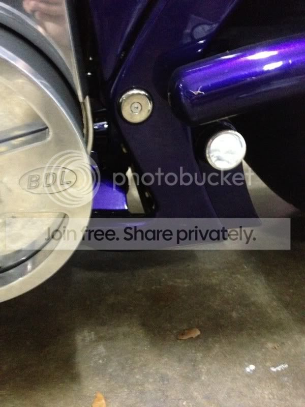

Here is my TX Chop on the side stand:

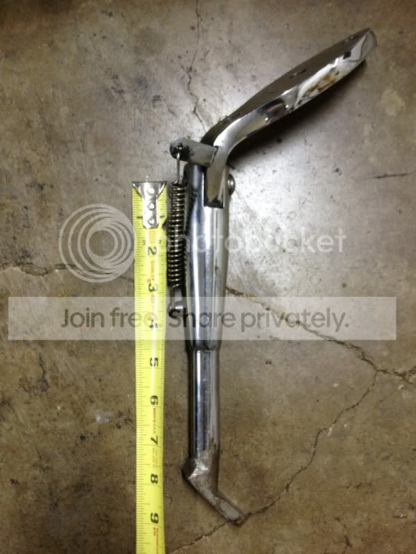

Here is the side stand I bought to cut down and use:

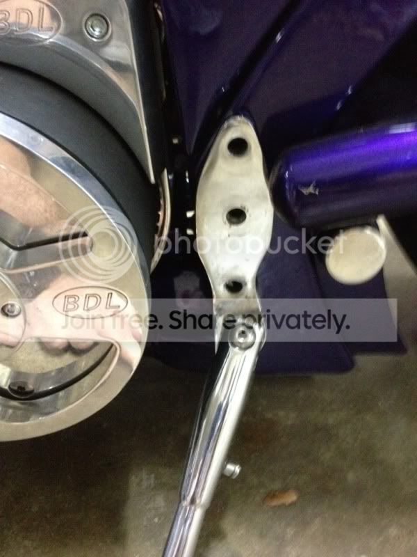

Here is how high it goes on the side plate.
That center bolt hole would be at the swing arm bolt......
You are looking for like a 4" side stand or to space it out over the swing arm bolt.
