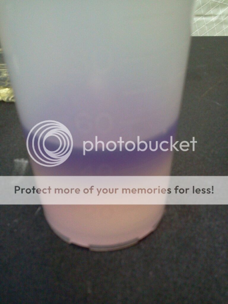

This is what happens when you mix the types together...kinda hard to see, but if you look close, you can see the nasty mess at bottom and the DOT 5 kinda floating on top of it...

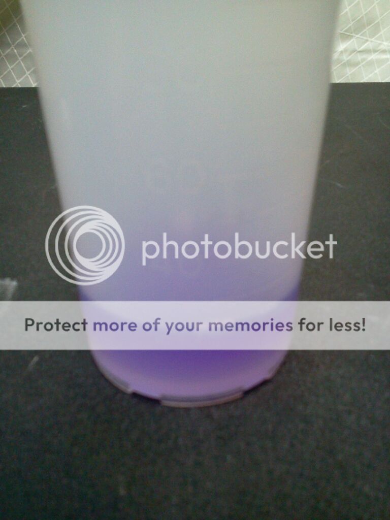

DOT 5 should look like this...with a purple dye added to it (dye does go away after time)

What happens when you mix the two together...Notice the DOT 5 is floating on top...
