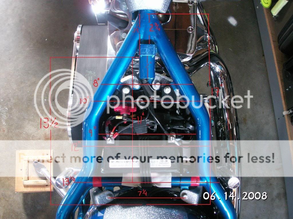

Wazzz up! I thought I'd put up some pic's of my Bobber seat conversion. First I measured frame to get an idea of what seat demension I can use..
I ordered what would be my best choice and have the option to use my stock seat if needed. picked up off ebay a LaRosa 9x13 with some hot knife work dark tan. 3" springs.
First I marked frame and drilled a 5/32 pilot hole then used a 17/64 and then tapped for a 5/16 NC18 cap screw.
Next I measured and mark the back cross frame tube for drill and tap for 5/16
Next I fitted with a 3/4 inch spacers under the lower spring to keep seat from bottoming out on battery.
You'll find that there is alot of adjusting to get it right but it was overall easy and took me 2 evenings. note: because of the battery the springs must sit 45 deg from front. I tried to face them backwards but the angle of the rear studs that hold the springs on face in a awkward angle for this.

I took it for a spin and wow!!!! now I don't feel every pebble on the road. rides real nice and soft.
enjoy the pic's..I'll try to get clearer pic's tomorrow and keep you updated with any issues. Take care.

not an issue yet but I do know you do sit a bit higher and forward but not by much but this does help keeping you in the seat. I thought of getting the deep pan seat but the measurements were off for what I needed and I was not sure if I could modify it to work. Here are more pics.
