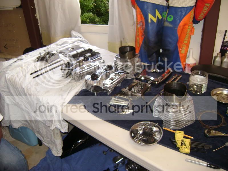

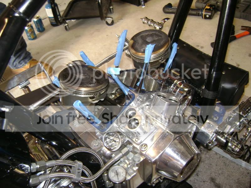

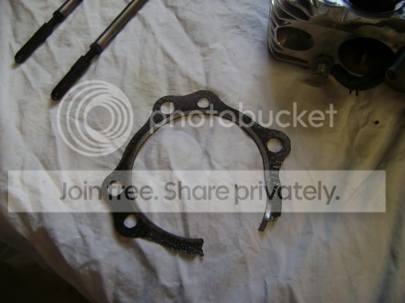

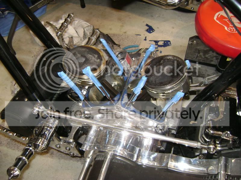

So riding out of DC at the top of 4th gear I blew the head gasket on the rear cylinder. I took the heads off and was going to change my head and base gaskets, but a knowledgable friend told me last night that there is probably some reason that it blew, and it's not likely to just be wear and tear. I am hard on my bike, I've got about 17k on this motor. Never had the heads off before, no motor work. Oil temps coming out of DC were around 200-240. We were in traffic for a bit, but I think we were on the highway long enough to cool it down. Anyone know how I can check the torque on the studs in the case? Maybe one pulled out a little? Also, while I have the top end off, is there anything I should do or check? I'm going to check the clearances on the rockers. What else?
