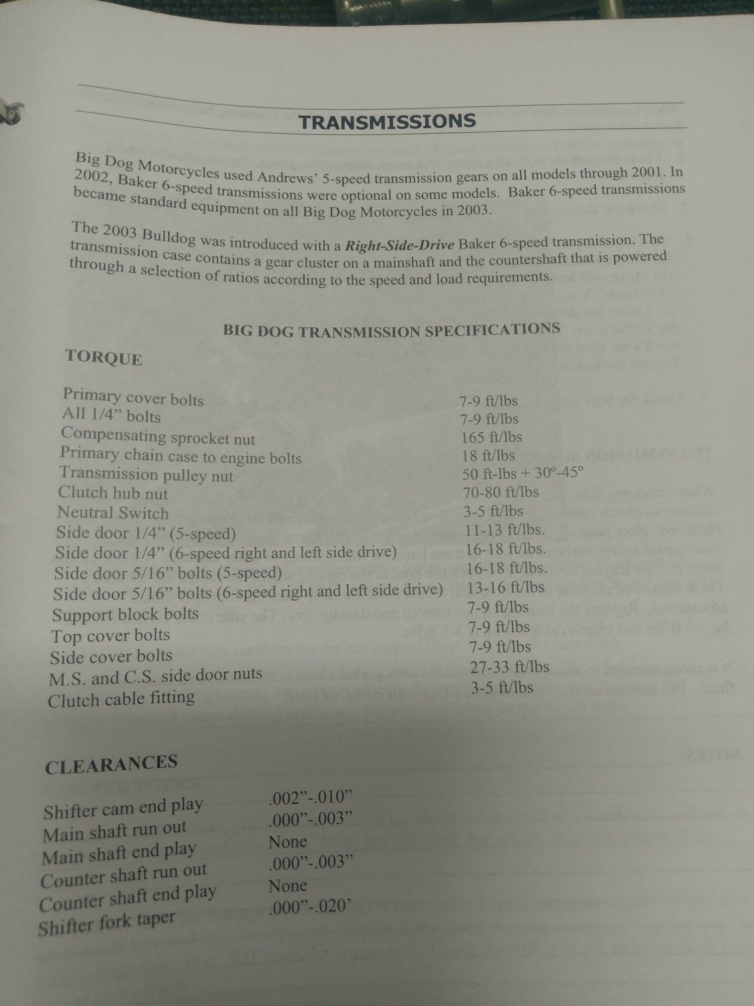

According to my manual Big Dog used Andrew's 5 speeds all the way through to 2001. The book says "gears" ...so may or may not be an Andrew's case, hell I'm not even sure Andrew's makes a case. But the Harley 5 speeds cases are all the same anyways so it's irrelevant.
Baker six speeds didn't come standard until 03

Well Eric you get the prize today,what ever that may be. My 2000 Prosport has a TP (total performance) case but according to Andrew Barnes who rebuilt it for me it could be either a Jim's or an Andrews gear set. He says it is nearly impossible to tell.
