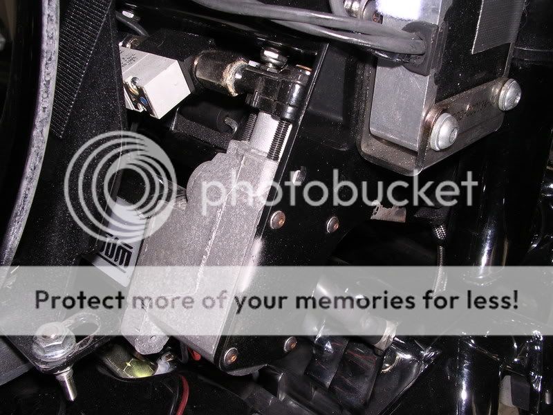

My compressor bracket broke... Picture below..:down:
What would have caused this.... :confused:
Im thinking the suspension was all the way down and then hit a big bump.. :bang:
I believe he took the rubber bumpers off so the bike would go lower...
I see the swing arm has a scrape on it from bottoming out... :angry:
My question is should i fix this bracket or should i fab up something new? :confused:
Or get one from Big Dog. :job:
Is this broken bracket from Big Dog? :confused:
ThX T-Mack :D :D :D

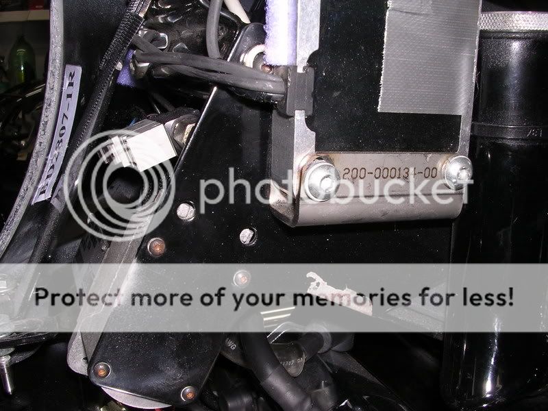

Well the bracket was attached to the battery box. I just took apart to fix and to show you guys... It had 2 nuts and bolts holding it to the battery box...
Sure send me a pic please that would help allot.. Plus im curious to see if this bracket was made up or from Big Dog..
Thanks T-Mack
T Mack
SUCKER FREE
THX for pics. Mine is not set up like that at all. Actually mine was mounted underneath the battery tray but on the other side. (horizontal)
Yours is mounted vertical compared to mine...
Thanks for the help and the pictures...
Im wondering if the Bulldogs are mounted like that and the Mastiff's are mounted differently.. Can anyone answer that one? Are they mounted differently?

Check out this thread on my Air ride. That is a factory bracket... I am working with dial-up here in Laconia so the posting is REAL slow.... Maybe some helpfull photos..
http://www.bigdogbiker.com/forums/general/5183-air-ride-failed.html
WOW. That answers all of my questions... THANK YOU N8KAM :D
Now I know where to start, and finish. Great job documenting... Very Helpful.
Now I hope I can buy that bracket alone. Ill call Aaron on Monday.
Also looking into welding up broken bracket. I'm dropping it off to my buddy who is a Tool Maker at work. Have him and the welder look at it and see what they think. A good welder should be able to make as good as new or better. Well see, i'll keep ya posted. T-Mack :D
