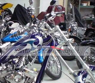

I'll post a photo of it later. The actual spot is where all the tubes come together at the neck. There is a triangle piece of metal in between all the tubes(see red arrow). Almost like the frame flexed, and the triangle piece of metal might have cause the paint to crack.

Now i see your problem, you have a red arrow stuck to your bike. :roll: No seriously. That is a strange place to have a stress crack. Does she ride straight? What does your local shop say about it?

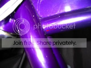

woodbutcher, no problem at all. I was looking at the crack in the paint, trying to get a photo of it, and I can't even get it to show up. I'm thinking it just might be from an air pocket between the weld seam and the frame, see attached. Its above the weld, not under the weld.

"Looking at the photo I don't you have a problem)..
