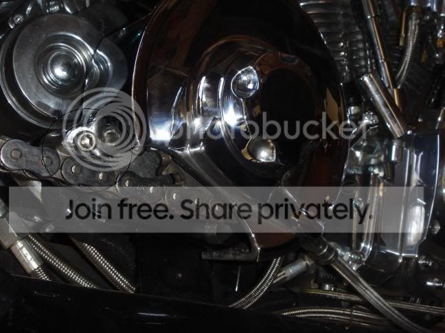

sprocket IS going to rub the lower front bolt to your door to the clutch ramp. i grinded the head of the bolt down
also the chain is going to rub the lower rear of the cover. need to chop most of it out

even cut like this it still rubbed the cover
here's the final hack on the cover
drilled a hole and tapped a bolt into the trans door. used a spacer on the bolt from cover to trans to keep it from flexing.
