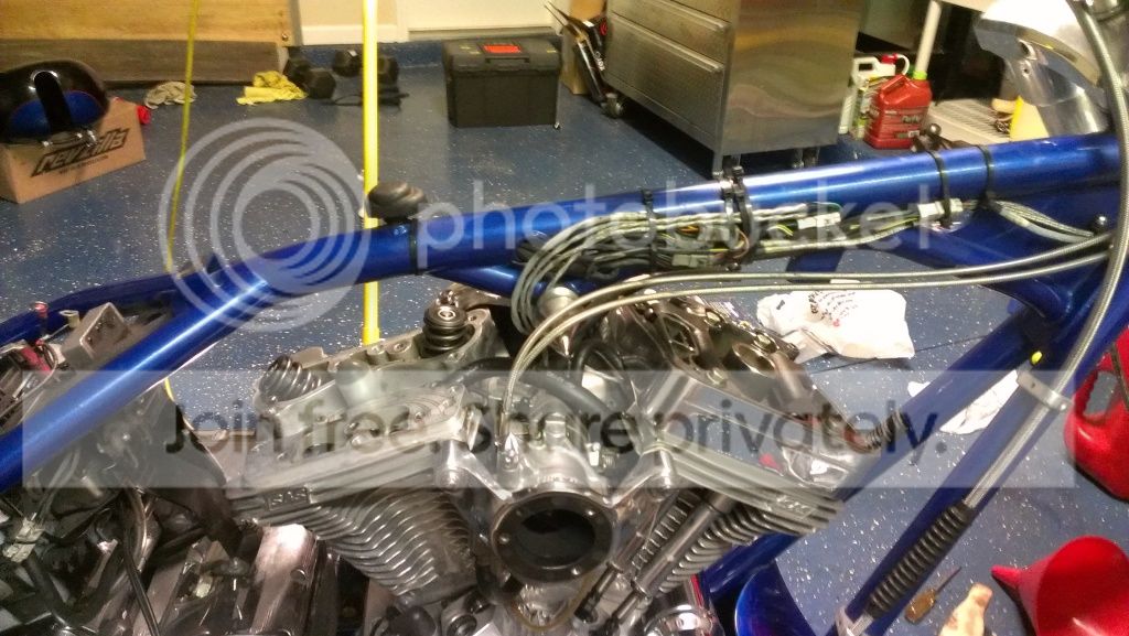

Now for a question, I have all the bolts out of the TP box, but it is seriously stuck to the gasket. Whats the safe way to break it free???
Gentle tapping with a rubber mallet and wood block wrapped in a soft cloth.
Just be patient and careful as when they pop loose be ready so they don't fall and hit something.

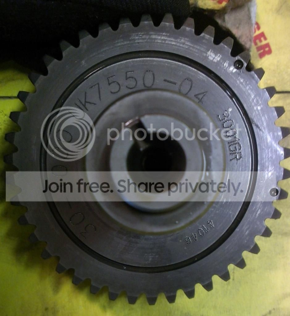

OK I finally got that cover off, it was really on there! Then I see this... Looks like this bike had the .569 comp cam put in....
Yes, standard info on here. Early 05's and 6's had .569 compcams and later they went yo the .549's

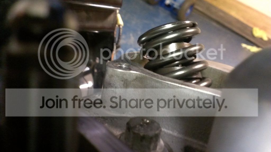

Oh, and what valve springs are these???
As I was told that is a Comp spring. They told me it was a double spring with a flat wound inner (spring as I call it) for harmonics. What the actual rating is they would not say. it has been a debateas to the max lift you could run when these. In the 05 I had I installed the .600 cam but I upgraded to the S&S .640 springs.

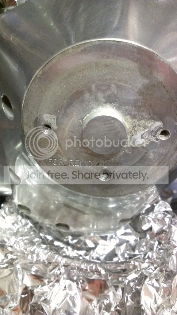

Is it me or are the S&S rocker boxes in your picture missing a bolt hole right next to the compression release? As I remeber there were 2 allen head bolts in the flat of the rocker box? Might compare it to the TP's you have to make sure.
I bought a rocker box of ebay and it was not the same as what was on the bike.
Might double check and I could very well be totally wrong. Me memory is shot.
Dan22644
You are correct sir, one less hole, the one very close to the compression release. I'm calling S&S tomorrow, I'll add this to my list of questions.
Has anyone run these springs with the 585 cam without issues???

Ok, unless someone can tell me what these springs are good for, this project is a complete failure. The valve covers will not fit as they are for an Evo motor head and the 117 uses a TC head, I already had the roller rockers, and I don't know if I can use this cam.
I'm sure all this knowledge was already on the forum, but I didn't see it :(
I think I'm just going to put it all back together and sell the parts. Look for a good deal in the swap meet!!
Sent from my HTC One X using Tapatalk 2
Dan22644
I'm not 100% sure but I believe the spring are good at least up for 585 cams.
No offense, but do you have a source for your hunch? I talked to a guy at CompCams today and he said there are two possible kits that were sold to Big Dog with the 30-4000 cam, both had double springs with the flat damper, but no way of knowing which ones I had without measuring the seat pressure. Of course one of them can handle a cam with over 585 lift, and one cannot :(
