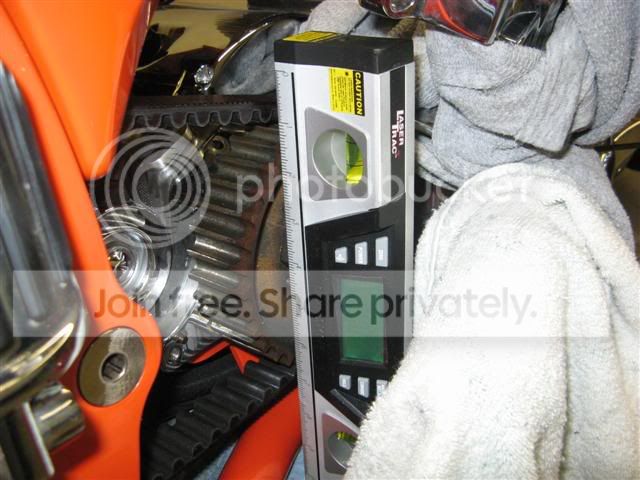

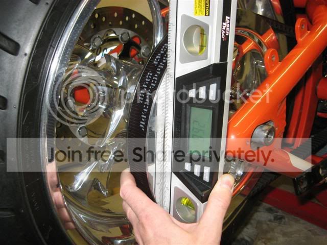

I think I have found the reason for my belt chirp and unusual wear of the teflon coating on my pulley. As stated in the service manual I measured the vertical angle of the rear pulley, the transmission trap door and the motor using a Craftsman digital level. With the bike on the lift the tranmission and the motor read 89.6 degrees while the rear pulley shows 89.1, also confirmed rear pulley reading by verifying brake rotor read 89.1 as well. The manual states all readings should be within 0.1 degree of each other. Since this is an 05 with the Rolling Thunder frame I am not sure if the swingarm is not square or the motor/tranmission alignment is off. I am thinking that shimming of the transmission might be the best fix, but I wasn't sure if the motor would need to shimmed as well. I wanted to see if anyone had worked with this type of alignment issue before and what the resolution was. Any info would be appreciated.

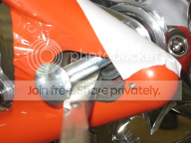

I divised a way to alter the vertical alignment to test its affect on belt tracking. I pulled the axle to the right side until it was not engaged with the swingarm on the left. I used a longer but smaller diameter bolt to support the left side of the axle and then used an assortment of feeler gauges positioned under that bolt so I could get the rear pulley to match the vertical angle of the front pulley. I setup the horizontal alignment and properly tensioned the belt. I started spinning the wheel and within 5 revolutions the belt was tracking just slightly to the left of dead center on the front pulley!!!!!! The belt tracked just to the outside of the rear pulley but I couldn't hear any rubbing.

For the vertical angle measurement I purchased a digital level from Sears which works very well. I initally measured the angle of the tranmission by placing the level against the trap door, but just to confirm the readings I have removed the the transmission pulley guard to measure the front pulley.
Also here is a picture of how I temporarily raised the left side of the swingarm to get the vertical angle of the rear pulley to match the front pulley.
I am convinced that the problem is with the swingarm since the tire actually becomes centered in the rear fender when the left side of the axle is raised to get the vertical angles to match.

Alhall and kickstar have valid points. If you are using the level and haven't verified the trueness of it make sure to always use the same side toward the piece that you are reading and the same side up or down each time. Not trying to be a wise guy at all just know a little about levels.
DRBarnhart
Insert title here...
It appears in the photos that he's using the same side of the level for all measurements.
The only value that's important is the .5 degree difference in his forward and rear measurements when the manual states it should be no more than .1 degrees. As long as he didn't "re-zero" the level between taking these measurements his results are good.
