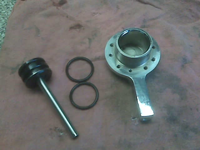

As a machinist, that would be a fun project to get the actuator mounted in there. If the hard pull clutch handle is your only reason to go through all that work, there are other options to make your clutch easier to pull.
