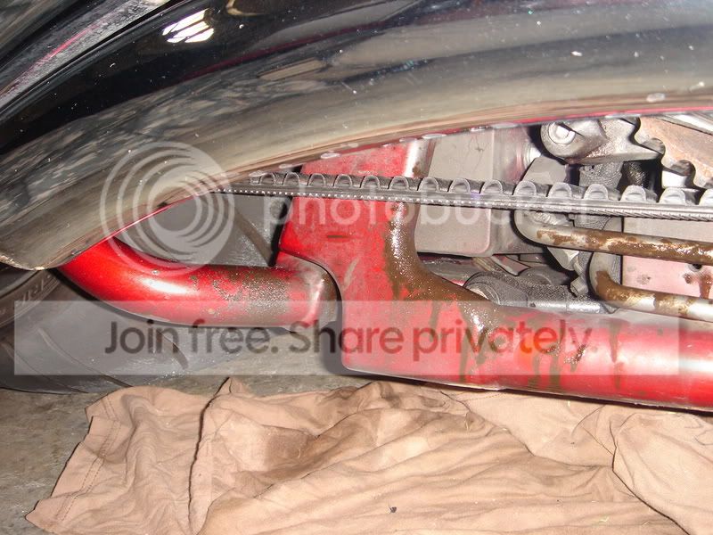

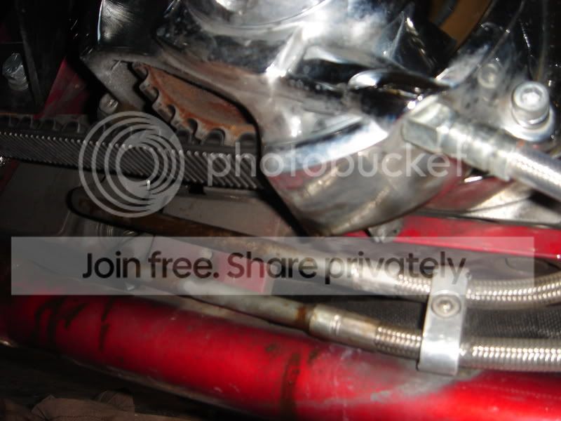

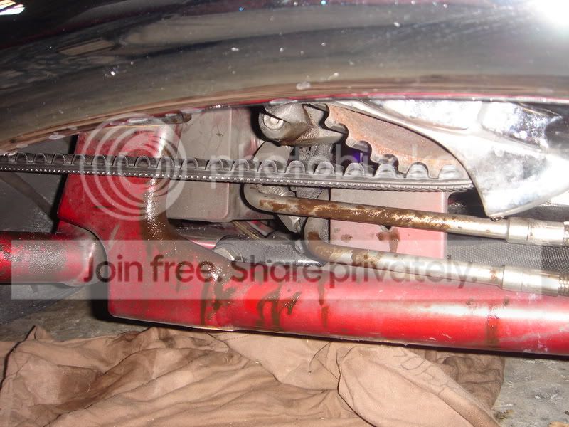

if the drive pulley nut is loose then the seal behind it will leak trans oil.is the stuff on the lobe side of the belt? my first thought was a slight leak from the trans drain elbow. second thought is bearing failure on trans letting fluid leak through. anybody else got an idea.
Thanks man. That is what I was planning on doing. I hope you are right.Check all your fluid levels then clean it off good and take it for a short ride and see what it looks like. It could be just road crap. Lets Hope!
Sorry to hear about the bad luck. Keep us posted on the outcome.Thanks for the help guys. I cleaned it up and looked around a bit, what I could, and then took her for a ride. She still spit oil everywhere. So, I dropped her off at the local authorized Big Dog service department. They just called and said that Big Dog recommends the starter and seal be replaced. P&L $613. Good times, good times. I need to learn how to work on this thing a little more.
I am telling you this place likes to replace shit when they dont know what the hell is going on. They give you your bike back and it is not leaking and then holy shit it starts leaking again. then they find another part they can replace and after another 600.00 it repeats itself Send me a PM I will try and help you out.:up:Yeah I'm concerned if it truely is the starter... think about it... why would the oil run to the right side. The bike don't lean that way on the kickstand. However, if the output shaft of the tranny is leaking and you then leaned it over if could drip towards the primary.
Guess we'll see....
I got home from work and noticed this. Not sure what is causing it. I could sure use some help.
