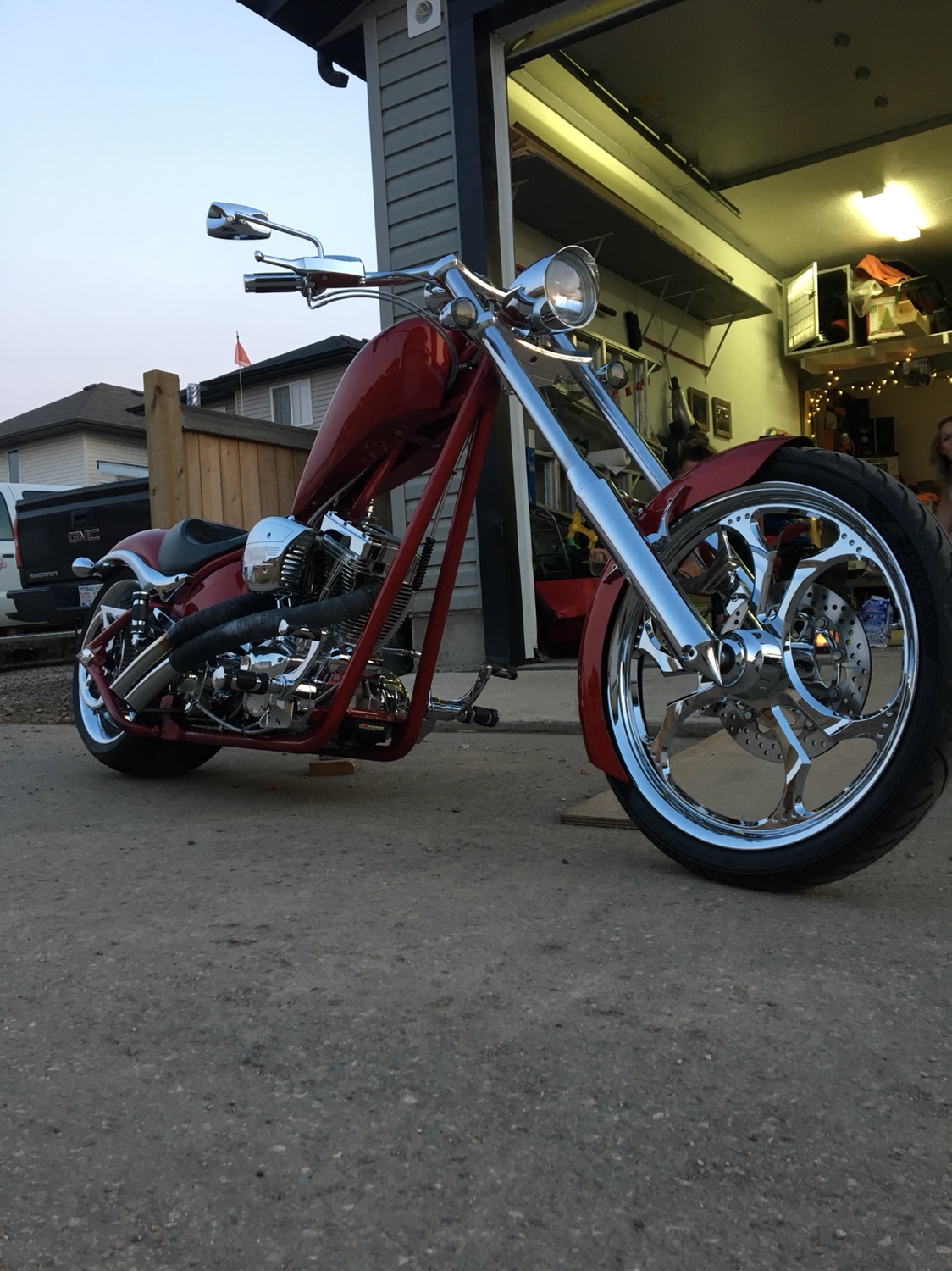

Does anybody know how or where to get touch up paints for the big dogs that match.
I am looking to find some candy apple red for my 09 K-9.
