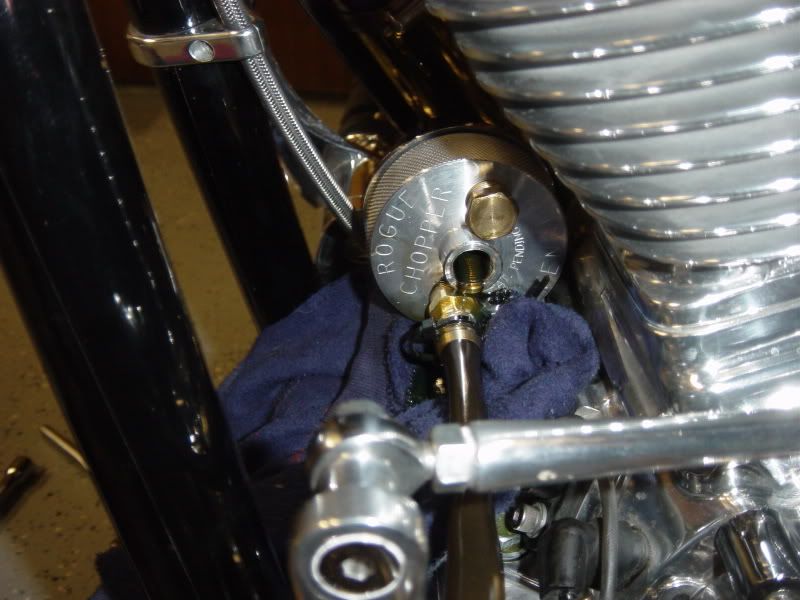

After you drain your old oil from your oil tank and replace it with new oil. Spin off the old oil filter and throw out as normal.
Spin on scavenger unit.

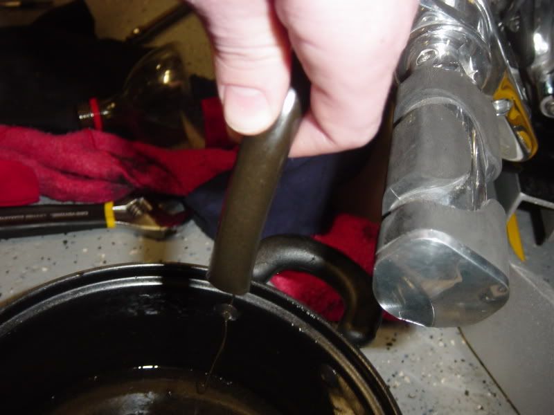

Start bike at idle and pump out the rest of the old oil that is still in your system. I removed about a extra quart of black black dirty oil.
See what you're wouldn't be getting out.
This is at about a 1/2 a quart into the evacuation of the old oil

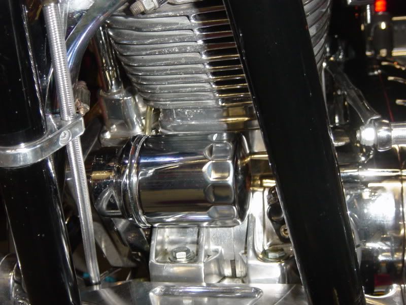

Now get yourself the new oil filter and BAM!
Remove your new oil filter from the package, apply a little bit of new oil to the new oil filter o-ring and spin onto the bike.
Check oil level in oil tank top off as nessicary. Start bike again to wet down the system. Allow to set. And top off again!
Went to Home Depot last night and picked up a 3/8 MPT x 1/2 barb adapter and some 1/2 ID clear hosing to add in another hose to the center hole. The one that leaks ALL over the place. Plus with the extra hose I lengthed the original drain hose.
Cost to modify... $10
Got to love it...

GasMan .... what is that bolt coming out of the center of your pic in the beginning of this thread? thx ... I just got mine yesterday ... can't wait to see how well it works. Got a washable oil filter too. Next project my EHC? thx again .. :2thumbs: :D :flag:
orion57
Gas Man, I just purchased the scavenger unit, I went to find a piece of pipe for the center hole but could not find anything to fit . I am not shure how you hooked up the hose to the center hole. Any information you could give me to help me out would be gratefully appreciated. Thank You. Bob
